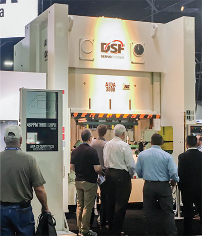

In addition to the press lines, other Aida servo technology on display included its exclusive Allen-Bradley based servo-press control for machines in capacities from 315 to 3500 tons. At Aida’s booth, the control demonstrated several servo-press stroke-motion profiles in real-time on a virtual press.

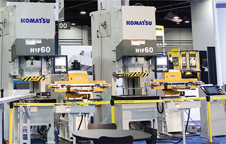

Komatsu H1F 60 single-point servomechanical pressesKomatsu had on display a high-speed robot-transfer press line featuring two of the company’s H1F 60 single-point servomechanical presses along with Orii RHN 120 two-axis robots. The best way to enhance such a line is to control idle time between robot and press and increase transfer speed of robot, according to Komatsu officials, who note that synchronizing both robot and press motions using digital technology has proven best for highest performance. The presses at FABTECH ran at different stroke lengths and speeds while synched with the robot system. Komatsu’s servo presses feature slide accuracy and repeatability in microns and fully programmable slide velocity for optimum throughput. They reportedly offer three times more working energy in the die space but consume 30-percent less electrical power than conventional mechanical presses.

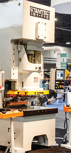

Stamtec iS1 series single point gap frame direct drive servo press Gap-Frame Servo Press Enables Process and Application Flexibility
Stamtec displayed its servo technology, including the iS1-series single-point gap-frame direct-drive servo press. Available in capacities from 88 to 330 tons, the series features Stamtec’s servo-motor-drive technology, where the standard electric motor, flywheel and clutch/brake are replaced with a high-torque, low-rpm servo motor. Proprietary controls specifically designed for the press enable a variety of stroke lengths and slide movement profiles, while supplying full working energy capacity even at low speeds. As a result, users have the flexibility to employ the press for drawing, restriking, warm forming and other processes, and easily incorporate automation and various feed options, according to company officials.
Also, user-defined motion curves allow as many as 20 various segments in a cycle curve, defined by slide-position, speed and pause-duration parameters.
