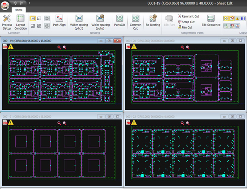

Newer software provides more powerful algorithms to fully optimize part fit up and sheet utilization. This includes the ability to nest parts within parts.
As shown here, where single cuts separate multiple parts, common-line cutting provides an example of productivity gains available through the use of nesting software.
“Fabricators, perhaps those producing appliance parts such as refrigerator or oven doors, for example, work with parts having internal cutouts for the glass or for some other feature,” Parenzan says. “Nesting parts within these cutouts reduces material waste and adds more parts to a sheet...it’s like producing those parts for free, at least from a material standpoint. A 20 by 20-in. square may have a 10 by 10-in. internal cutout. Not taking advantage of that means wasting a 10-in.-sq. piece of scrap.

Common-line cutting, where separate parts benefit from a single cut, provide another example of productivity gain available through nesting software.
