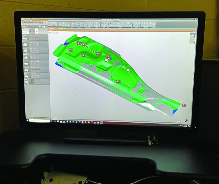

draw feasability“A lot of prototype door-inner parts seem to be wildly shaped,” he says. “In fact, we’re developing a door inner right now where all of the reinforcements are very complex.  I’m used to working with true radii and overall good geometry. But recently, I’m seeing designs that, rather than including blended radii, often feature surfaces in CAD mated without specified geometric properties—no radiuses, just a weird, formed shape. Luckily, because of my experience and the capabilities of AutoForm, I usually can go in and fix the surfaces to make them useful in die development.”
trimming moduleOnce he started using AutoForm at PTM, Boghian took note of the software’s expanded capabilities, in particular its ability to take data from a 3D scan of a stamped part, created by the AEC’s quality department, and compensate the die design to make the part to spec.
“There aren’t too many companies using AutoForm in this way,” Boghian says, “but I find it very useful to take the actual output—the stamped prototype part—and go back into the tool design and reengineer it if needed. Typically, this occurs if the sheet metal properties don’t exactly match what our designs are based on.”

AutoForm-StampingAdviser enables Boghian, he explains, to quickly evaluate part and process feasibility for new designs coming down from customers, to perform springback analysis and compensation to help develop blank shape and evaluate material utilization.
“I can check and compensate for splitting and excess thinning,” he says, “as well as for the potential for wrinkling.”

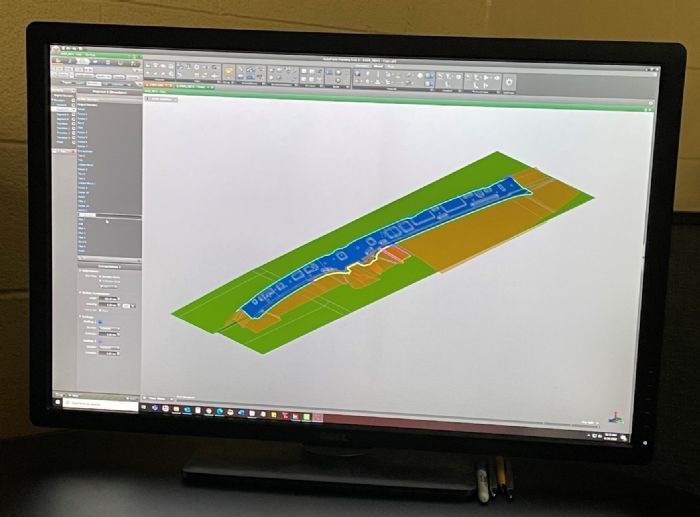

With DieDesigner, Boghian can use CAD part geometry to develop—and adjust—die-face designs, as well as create addendum and then automatically develop flanges on to the addendum surface.
“Then, using Compensator, I can modify the die surfaces based on precise springback calculations,” he says, “or measured springback, defining compensation regions or the complete surfaces.”

Last but not least, PTM’s AEC has been an early user of AutoForm-DieDesignerPlus, which allows a designer to create part-geometry features within the AutoForm interface.
“I can use the software to quickly create CAD-quality die-face geometry without using a separate CAD system,” Boghian notes. “That can make the process very efficient. Theoretically, we can design an entire tool inside of AutoForm and not have to take any new surfaces created back into CAD to fix them. Now, we can go right from AutoForm and cut the tool, the surfaces are that good.” MF
