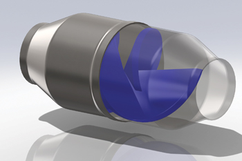

• A patented selective catalytic reduction (SCR) mixing module;

P & C has developed a number of self-contained systems to aid in the atomization and mixing of diesel exhaust fuel.
Apropos to the 2003 passage of more stringent Corporate Average Fuel Economy standards, P & C is continuing development of its SCR process. Pridgeon & Clay has worked with several OEMs and Tier 1 companies to design, build and test countless SCR systems that detoxify exhaust emissions, many of which are in production today.
