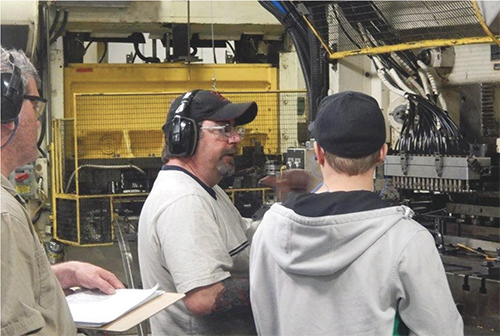

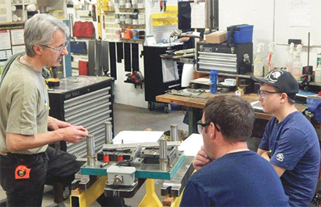

hands-on die training for shop-floor personnel
In-depth theoretical and hands-on die training for shop-floor personnel is a major component in the company’s drive to adopt new technologies such as die sensing and error-proofing.
“Our training program is critical to the success of the sensor program and, in fact, the effective use of all shop-floor technology because, at the end of the day, the technology is only as good as the operator using it,” explains Mary Jane Bushell, Larsen & Shaw president and chief executive officer. “Operators must have an understanding of the entire system to enable efficient and safe production. Additionally, operators must have an ability to troubleshoot to quickly resolve problems. Effective troubleshooting requires an excellent understanding of the total process.”
Bushell also stresses the importance of properly training new employees.
“The majority of our new employees have no press-operating experience,” she says. “Also, operators on the afternoon shift have less support available for troubleshooting problems, so they must be more self-sufficient. Therefore, a robust operator-development program is essential for their success and the success of the team.”
The company’s skills program involves a combination of classroom, online and hands-on training complete with competency assessments throughout the process. Larsen & Shaw has developed its own standard work, core and technical modules and has recently organized them into a formal training plan by work area. Skill sets are established upon successful completion in various phases.
“This leads to development of competent operators much earlier in their careers than in the past,” says Bushell. “It’s a morale booster since we all want to feel good about our accomplishments each day. The next steps are to build this into the architecture of our new ERP system (from Plex Systems, Troy, MI) so that the training programs and progress will be more visible than ever before.”

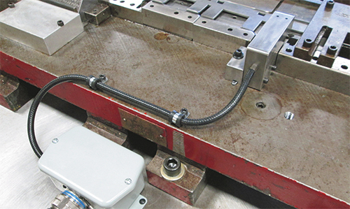

existing die at Larsen & Shaw have been retrofitted with a feed sensor
An existing die at Larsen & Shaw has been retrofitted with a feed sensor using best practices, including placement of a steel block to protect the sensor, robust conduit to shield the cabling from damage and a quick-die-change connector.
