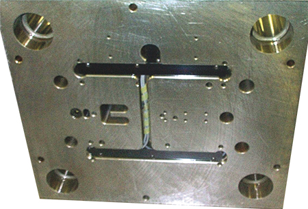

Not Planning for Sensor Wiring Prior to Install
Cable damage accounts for more sensor replacements more than any other cause. Avoid damage by using die-mounted junction boxes and carefully planning the sensor-wire routes to protect the cables. Often, the most difficult part of installing a sensor is figuring out how to route the wire from the sensor to the junction box. Waiting until the die is assembled and the sensor installed is probably too late. All new die designs should have the sensor wires included on the CAD drawing.

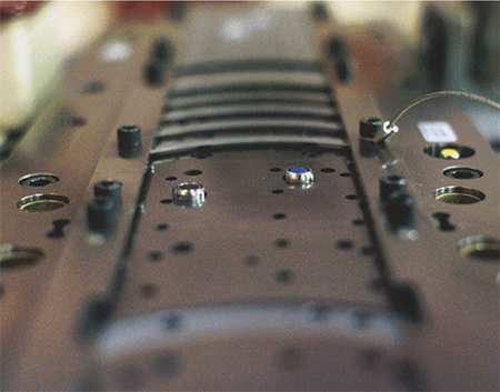

well-thought-out wire route
Here’s an example of a well-thought-out wire route. Cable damage accounts for more sensor replacements more than any other cause. Avoid damage by using die-mounted junction boxes and carefully planning the sensor-wire routes to protect the cables. All new die designs should have the sensor wires included on the CAD drawing.

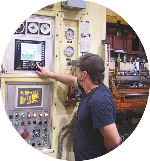

A machine stoppage initiated by the die-protection system when no real problem exists is known as a nuisance stop.
Upon the first nuisance stop, a conscientious machine operator carefully scrutinizes the error message from the controller, thoroughly inspects the press and die to locate the fault, and, only upon finding nothing wrong resets the error and restarts the machine. The next time a stop occurs, the operator might not read the message as carefully or inspect the machine as thoroughly. After that, you’re lucky if the operator gives a casual glance at the controller and die before pressing the reset button. Should the nuisance stops continue, it is only a matter of time before the sensor is disconnected and the system disabled.

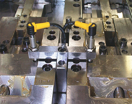

Place proximity sensors, so that the possibility of sensor damage is minimized should material or a tool locate out of position.

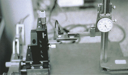

Using setup personnel to adjust the sensors. Adjustable sensors seem like a good idea—install them in a rough location and have the setup person fine-tune the sensor with each die run. But besides being labor-intensive, this practice can lead to nuisance stops. Setup personnel may lack the training or expertise to properly adjust all sensors for all conditions. The goal of any installation should be to select a sensor that never needs adjustment, and a location where the sensor will stop the machine only when a real problem is present. ‘Plug it in’ should be the only task for the setup person. A properly bench-tested sensor should be installed so that it will never have to be moved or adjusted. While an adjustment might come in handy initially, adjustability becomes a liability once the sensor runs correctly.

Requiring too much precision. Though desirable, a high level of precision is not always needed when installing sensors in the die. For example, with a bit of bench testing one could easily install a proximity sensor in the die to detect a strip misfeed of as little as 0.0005 in. But this almost guarantees ongoing nuisance stops because such a level of precision is unobtainable in most production environments. If you determine that the pilots can align the strip when it is misfed by ±0.010 in., then install sensors so that they won’t signal a stop unless the strip misfeeds by more than 0.010 in. This provides the setup person and equipment enough wiggle room to keep the process running while still protecting the die from misfeed damage.  MF
