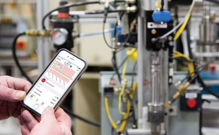

parker-hannifin-iot-condition-monitoringWireless condition-monitoring systems rooted in the Internet of Things (IoT) reduce labor costs by allowing plant personnel to instantly access condition levels from wherever they can connect to the internet. 
