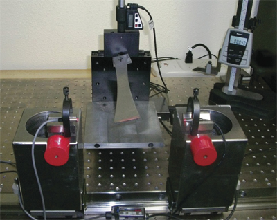

A through-beam photoelectric sensor simulates and verifies part detection.

For starters, Wittkopp believes firmly in the importance of thorough sensor-to-target bench-test simulations. He uses an x-y-z precision positioning table and an assortment of fixtures to simulate the use of a through-beam photoelectric sensor to detect the feed length of a part. Using the track and slides, the transmitter and receiver are accurately positioned to match the distance and angles at which they will be mounted inside the die. The part then feeds into the beam using the x-y-z mechanism to ensure precise feed detection to the requirements of the die. After numerous iterations, the correct position of the sensor relative to the part’s edge is determined.

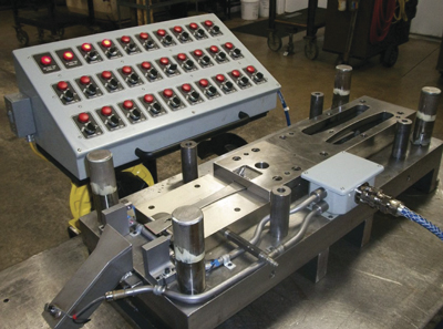

The third critical requirement: A thorough inspection of the die and its sensors in the toolroom, prior to its delivery to the pressroom for production runs. A superb HTT sensor test cart is used by toolmakers to power-up the sensors and verify proper functionality. In the case of the feed sensor, the strip would be fed manually and precisely into the light beam to ensure proper detection of a short feed. As the Russian proverb goes, “Trust but Verify.” Why would anyone send a die to production without ensuring full and accurate functionality of all of its sensors?
HTT’s sensor test cart contains everything needed to test a sensored die in the toolroom.
