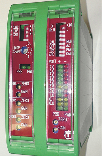

Toledo Integrated Systems will debut its new ZT force-measurement signal conditioner at FABTECH. The ZT-1 is available as a one channel peak and reverse peak device, with options for up to four-channel applications. The device features electrical noise filtration and is designed to be used with standard strain-gage-based sensors and load cells for force measurement. It is equipped with an LED bar-graph display for easy setup and diagnostics. The ZT also can be configured for 20-mA current input. Standard output is ±10V and channel one also provides 20-mA current output.  www.toledointegratedsystems.com
