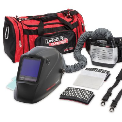

PPE—Employees exposed to hazards created by welding, cutting or brazing operations must be protected by personal-protective equipment (PPE) in accordance with OSHA requirements. Appropriate protective clothing required for any welding operation will vary with the size, nature and location of the work to be performed. Burns from touching hot surfaces and not using PPE poses one of the most common welding-related risks, as does electrocution from high voltage and electrical current.
Welding PPE may include welding hoods, goggles, nonflammable shirts and pants, welding gloves and steel-toed boots. A respirator or positive pressure hood can minimize exposure to metal fumes produced during the welding process.
