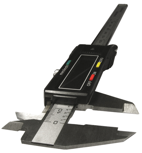

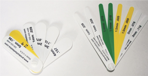

Feeler, Step and Pin Gauges, and Hole Position/Size Templates
Feeler and step gauges (shown here) offer simplicity when measuring stamped parts, providing the die maker and the stamper a good sense of the dimensional accuracy of
a panel.
This is the simplest form of stamped-part measurement, providing the die maker and the stamper a good sense of the dimensional accuracy of a panel. While this type of measurement approach typically is simple, the designer/manufacturer of the checking fixture must plan to include rails around the part to enable the use of feeler/step gauges around the panel. This technique enables relatively quick measurements, and allows inspection wherever rails are available—critical for areas of components where parallelism matters, such as door outer edges.
A significant disadvantage of this measurement method is the cost incurred to build rails onto fixtures, and the lack of documentation. Over the life of a typical fixture, its use typically will diminish as the stamped product attains dimensional stability. A significant portion of part measurement takes place during die verification and tryout, during which the process stabilizes and the part requires less frequent inspection. Also, we often see use of hand-written documents (sometimes scanned into electronic files) to document these measurements, not ideal for entering results into a database for future access. One other significant disadvantage: the lack of repeatability and reproducibility, since these techniques are highly operator dependent and require extensive operator training.

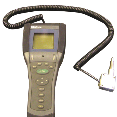

Electronic Data Collection Using “Datamytes”
Though a number of such devices are available, the term “datamyte” has practically become a generic name for the use of a bushing and an electronic transducer to check panel dimensions. The transducer makes physical contact with the part and the dimensions are collected in a database for future analysis using statistical tools such as x-bar and r charts that enable tracking of results over a specified period of time. The process takes less time to complete than does use of feeler, step and pin gauges, requires less operator skill, and allows for a high degree of repeatability and reproducibility.
The term “datamyte” has practically become a generic name for the use of a bushing and an electronic transducer to check panel dimensions. The transducer makes physical contact with the part and the dimensions are collected in a database for future analysis using statistical tools such as x-bar and r charts.
Using a datamyte, the process designer must plan for the use of transducers and budget for the cost of the bushings. Also, these standardized transducers allow the user to check part quality only at predetermined, discrete positions, which makes it impossible to measure a part for V-gaps or any changes in the profile along its length. Hole sizes are not easily measured, and hole positions must be measured with templates.
