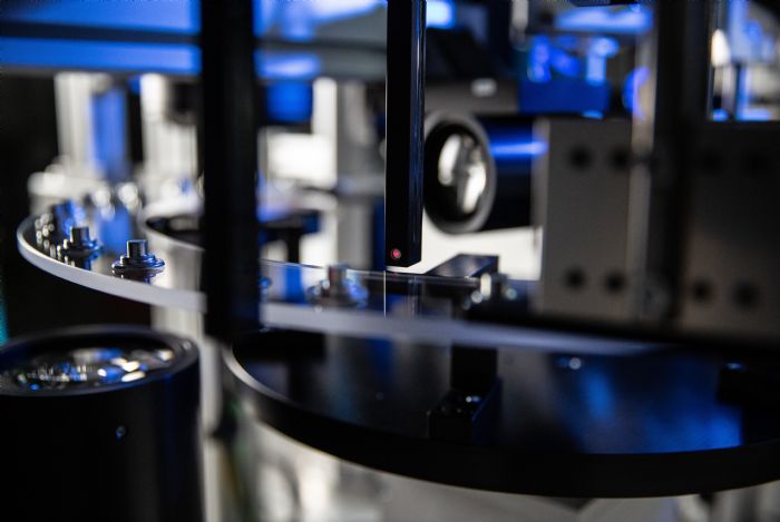

At Plogsties, the KVC 821 vision system and other modular standalone test cells ensure seamless quality. The KVC 821, according to Kistler officials, can capture entire lateral surfaces of test parts in high resolution, thanks to a new multi-capture device, which features eight mirrors arranged in a circle. And, a rotating glass plate stages parts for inspection, meaning that parts no longer have to be mechanically rotated, they explain, and defects such as scratches or dents can be detected precisely in a single pass. This way, the camera station enables cycle times of as many as 400 parts/min. The KiVision image processing software uses AI-supported algorithms to detect previously unknown anomalies.
