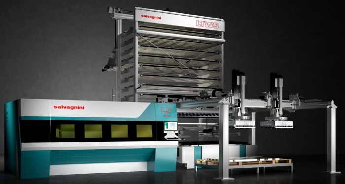

salvagnini-robot-automationMotion-control technology provider Moog Inc. has partnered with Salvagnini, a provider of equipment for automating metal forming applications, to develop an eight-axis Cartesian manipulator robot for automatically directing and sorting parts produced on punching and shearing machines.  The setup is designed to effectively handle a high variability of batches, as well as small and diversified batches, and meet requirements for short delivery times and customer-quality guarantees. Salvagnini’s eight-axis manipulator fits into an existing floor layout while performing a variety of tasks, all while consuming less energy than competing designs, say company officials.
