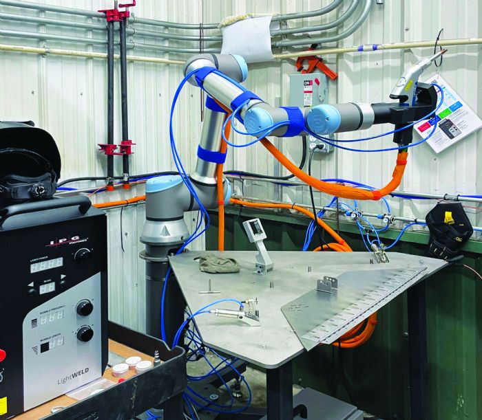

Knopp proposes a simplified hypothetical scenario with an initial investment of $150,000 in a cobot-laser-welding system that also needed accessories. Such a setup, depending on component volumes and system green time, may yield annual savings over traditional welding processes of $50,000 for labor, via faster welding cycles and reduced reliance on manual labor; $20,000 caused by scrap reduction, due to improved weld quality and repeatability; and $10,000 of savings for maintenance, based on easier upkeep of cobot-laser welding setups. This places ROI at about 24 mo., relates Knopp. He explains that the $50,000 in labor savings represents savings across a single 8-hr. shift.
“Many companies,” he says, “work two or three shifts, which would accelerate ROI and reduce the payback period even further.”
While the ROI example above is hypothetical, cobot-led laser welding has proved its worth in the real world, as the experience of Quality Tooling & Repair (QTR) shows. QTR is a Cobot Systems sister company in North Versailles, PA—both were recently acquired by Cutting Edge Machining and Automation.

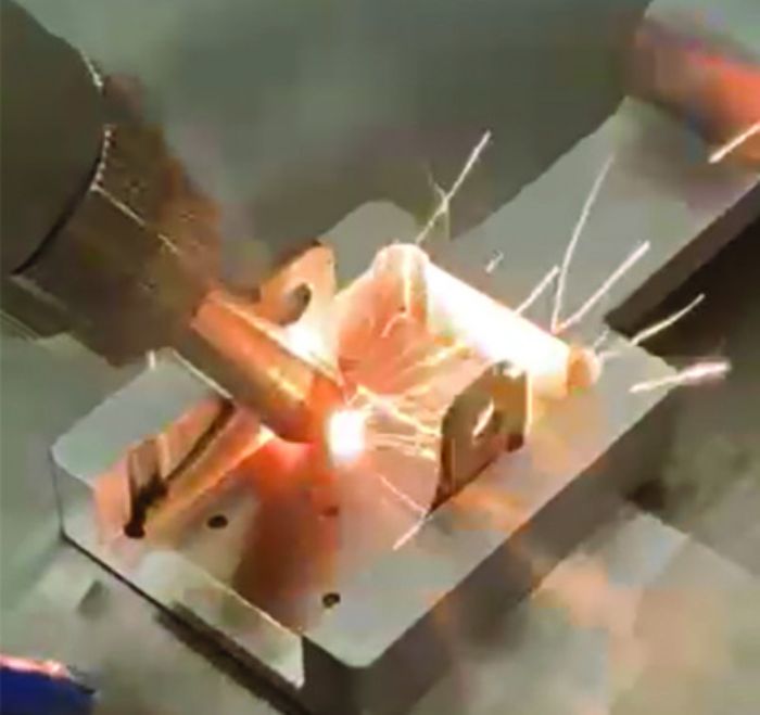

Prior to employing cobot laser welding, QTR had been manually performing production gas-tungsten-arc welding (GTAW) at the rate of 90 min./component. The firm sought a significant cycle-time reduction. Channeling its machine-tending experience with cobots, QTR married that technology with laser welding to drastically reduce the aforementioned cycle time to 10 min./component. In addition, QTR officials report elimination of other problems such as distortion previously encountered with the GTAW process. And, laser welding eliminated the need to clean parts.
Following this successful trial experience with the cobot, QTR and Cobot Systems worked to standardize the cobot-laser-welding system and offer it to the fabricating community. MF

In particular, laser welding offers significant advantages in volume production over traditional welding methods, primarily when joining thin materials—carbon and stainless steels as well as aluminum in thicknesses less than 0.25 in. Tightly focused laser beams enable high-quality welds while minimizing heat input, which adds to weld quality while allowing immediate post-weld handling. Low heat input also means minimal part deformity or shrink. And, narrow welds achieve impressive depth and high strength while proving exceptional for joining very small components. Another plus for laser welding: the ability to join a variety of materials, including dissimilar alloys.
