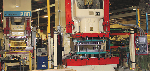

New controls at D & H Industries had to be configured to meet the needs of any manufacturer’s presses, including these two 200-ton gap presses. “Now, when operators walk up to a press they see a similar screen and function layout,” says D & H manufacturing engineering manager Jim Meyers, “which makes it easier to train operators to use multiple press lines.”

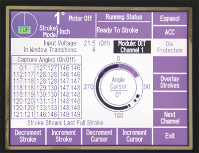

Even controls equipped with fewer die-protection inputs include valuable features. For example, the circular press-stroke chart shown here illustrates, in blue, where in the stroke the sensor needs to transition; the black shading shows in real time the actual points in the last stroke where the sensor switched on and off. This type of interface makes it easy for operators to see what is happening, and to properly program the unit.

The new controls store in memory the points in the stroke where a die sensor turns on and off, over consecutive strokes. When setting up the sensors, this allows an operator to identify the best place to set the on/off angles, a time-saving feature that also helps ensure proper die-protection practice.
