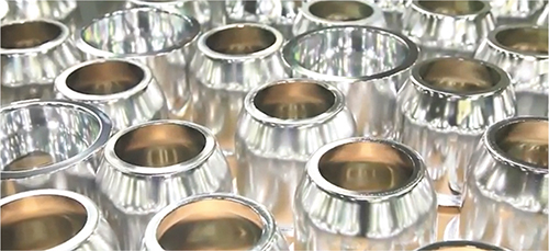

The move to LED lighting in residential and commercial settings, in place of incandescent, not only impacts aesthetics and efficiency but also sheds new light on metal-fabrication practices. For starters, reflectors typically made by hydroforming now are spun; heres a new spinning tool lighting the way to improved profitability.
Down south in Lithia Springs, GA, metalformer and fabricator Reflek Manufacturing calls itself “your partner for a brighter future.” That’s because the company manufactures millions of dollars’ worth of aluminum reflectors every year from its 100,000-sq-ft. facility.
The need to throw light from LEDs around a room, so it’s not directed at people and creating glare, has increased the demand for spun aluminum reflectors, keeping the 15 spinning machines at Reflek humming. Its CNC spinning machines, all M&M models, “spin aggressively,” says Dorsky, “because we’re always trying to reduce our lead times and get as many parts out the door as quickly as possible. We push the limits of the machines, which means we’re also pushing the limits of the tooling. We don’t cut slowly and smoothly like other metal spinners might, where the tools can last virtually forever. Our aggressive process requires the state of the art in tools, to keep our costs down and to maximize machine uptime.”

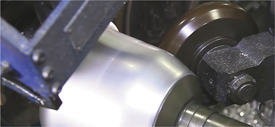

On the shelf at Reflek that’s reserved for spinning tools are newer nonmetallic wheels cut from a proprietary polymer. Compared to the polymer wheels the firm previously used for spinning, the newer tools have resulted in a 15 to 20 percent jump in durability and a 30 to 40 percent decrease in cost.
“The machines generally run two shifts per day five days per week,” Dorsky says. “They’re our workhorses, the cornerstones of what we do, and the XU2 wheels have noticeably reduced our costs.”
Reflek purchases the XU2 product in 14- to 16-in.-long cylindrical slabs from Boedeker, and cuts its spinning wheels from the slabs on a lathe in its inhouse machine shop. Most blanks are either 6-, 8- or 12-in. dia., and each size requires a different spinning-wheel size. Wheels range from 2 to 2.5 in. thick.
The material is easily machinable, Dorsky notes, “so we can quickly trim a wheel down to satisfy a custom radius on the outside, for specific or unique applications, rather than using our standard 3⁄16-in. edge radius. And, it’s easy to recut the radius as the wheels wear.”
