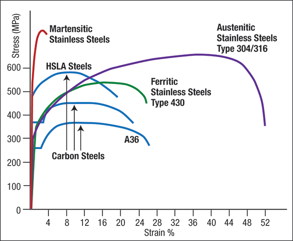

For example, most stainless steels have work-hardening rates greater than those for plain carbon steels. Many stampers wrongly believe that stainless steels are less formable than low-carbon steels because they work-harden excessively. However, many grades of stainless steel have substantially higher ductility than mild steels, and metalformers frequently deep-draw stainless steels into very complex shapes without performing intermediate annealing. Even the less-formable ferritic grades have outstanding ductility (see illustration).
