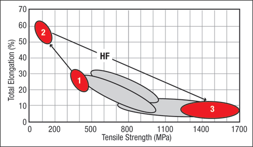

Information in AHSS Application Guidelines compares these new steels to HSLA and conventional low-strength steels. For example, the section on springback applies to all steels. Some higher-strength steels are designated by yield strength or tensile strength, depending on global location and strength values. For example, the document uses the format HSLA 350/450 that designates type of steel, yield strength (MPa)/tensile strength (MPa). The SAE has proposed a similar format of DP 600T/350Y in SAE J2745—Surface Recommended Practice for Advanced High Strength Steels. AHSS Application Guidelines also includes typical engineering and true stress-strain curves for the different types and grades of higher-strength steels compared to mild (AKDQ) reference steel. Fig. 2—Segments of the Fig. 1 curve can be used to describe hot forming and other steel processes. Courtesy of WorldAutoSteel.
