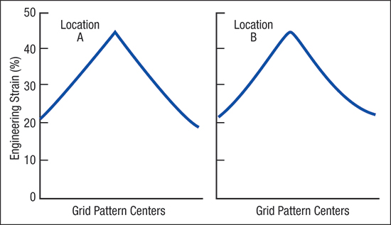

Fig. 1—Stamping has two areas with identical final strain distributions. |

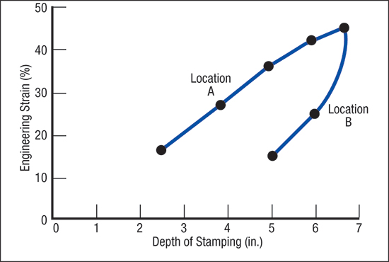

Fig. 2—Two locations on the same stamping with identical final strain distributions exhibit widely different strain histories. |

Consider this case study illustrating how a conversation with the stamping can solve a random breakage problem. Under investigation: two locations on the punch, A and B, 3 ft. apart. The two strain distributions, measured at full depth or home stamping, are nearly identical (Fig. 1). Location A appears stable and never fails, while location B experiences frequent breakage. The available data proves insufficient for identifying the problem, or a solution.

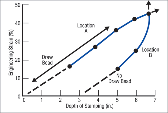

Fig. 3—Strain history for Location A was uniformly controlled by a draw bead. Location B started with the blank freely sliding into the die. It then formed a buckle at 6 in. of stamping depth that greatly changed the final strain history. |
Step one is to identify the strain history by asking the stamping for a series of incremental hits or breakdown stampings (Fig. 2). Location A appears to have a constant rate of straining until the very end of the stroke, where the rate of straining decreases. Location B exhibits the opposite behavior, as forming begins later in the stroke and then increases its rate of straining as the stroke approaches home depth.
Next we extend both strain histories back to their starting points (Fig. 3). Location A begins straining as soon as the punch contacts the blank, with a constant rate of deformation. Approaching home depth, the geometry almost is complete and strain rate tapers to zero. In the blankholder we find a draw bead exerting a restraining force and creating constant blank movement into the die opening.
However, material at location B does not strain for the first 3.2 in. of punch travel. In the absence of a draw bead, the blank slides into the die opening without deformation. This free flow causes the material to gather and elastically buckle, causing the blank to lock up in the binder. As such, all length-of-line must come from elongation over the punch, at a catch-up pace. Approaching home depth, the material flow rate spirals out of control. As a result, small changes in the 50-plus input variables can easily drive the strain above the failure limit. Ask the stamping what it needs at location B, and the answer is: “A good draw bead.” MFView Glossary of Metalforming Terms
