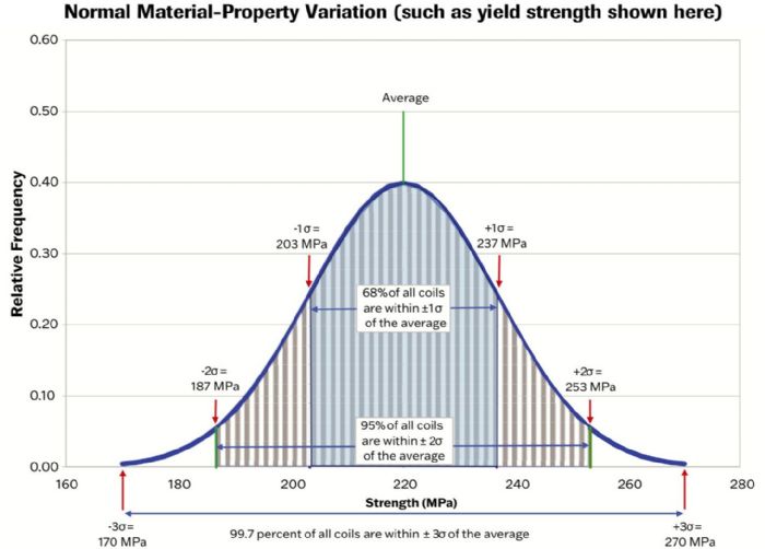

While sheet metal suppliers might target specific material properties, they may struggle to attain those values repeatably. Instead, ensure that the properties have a distribution that falls within the material-grade definition. The specification likely constrains these requirements, but multiple suppliers might provide different property distributions. Therefore, metal formers should strive to develop stamping processes that will accommodate the full range of material properties that could be received, not just what has been dialed in based on restricted inputs during a handful of trials (see the accompanying figure).

Regardless of the scenario, ensure that production personnel know what’s normal when it comes to sheet metal properties, and what’s unlikely but allowed in the specification to which you ordered the material. Making tooling changes to accommodate rare properties might upset an otherwise stable process. MF
