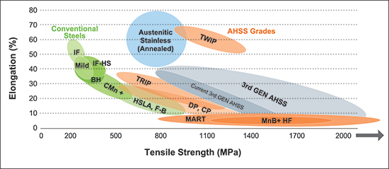

Cold Forming–Stretchability: For traditional low- and medium-strength steels, n-value decreases as yield strength increases. As n-value decreases so does overall stretchability. A lower n-value encourages the formation of highly localized strain gradients, which can cause early failure.
Increasing n-value is one goal of AHSS. For DP steels, an increase in n-value in the engineering strain range of 4 to 8 percent helps to prevent the formation of severe gradients. However, n-value decreases back to that of a high-strength low-alloy steel of the same yield strength. Therefore, no increase occurs in the terminal n-value or FLC. In contrast, TRIP steels have an initial n-value climb that is maintained throughout deformation. These steels prevent the initiation of gradients and increase the allowable stretchability defined by the FLC–a double benefit.
