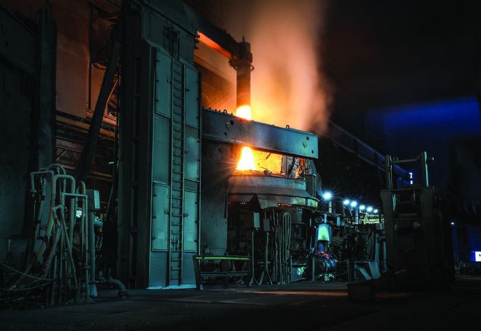

Steelmaking chemistry control in blast-furnace and basic-oxygen-furnace technologies has advanced over the years with better processing equipment and better process modeling to produce 3rd Gen AHSS.
Cleveland-Cliffs makes its Gen 3 AHSS with a different composition than other mills might to achieve high-strength/high-formability properties. Some of that is related to its melt shops’ material process capability, and the thermal mechanical processing that it goes through. Differences also can be related to new developments in finishing operations and the coating lines. Improved heat treatment controls on the coating line allow for coated steel sheet to be annealed inline, then quenched and tempered to develop high strength with improved formability. This capability is critical for the better formability in 3rd Gen AHSS.

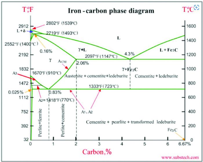

Dean Kanelos, market development and product applications manager, Nucor: Steel makers have developed many new grades with different microstructures than conventional steels. Nucor has developed several high-strength multiphase steels and is developing 3rd Gen dual-phase steels with high formability/ductility to meet future demands for improved formability at higher strengths.

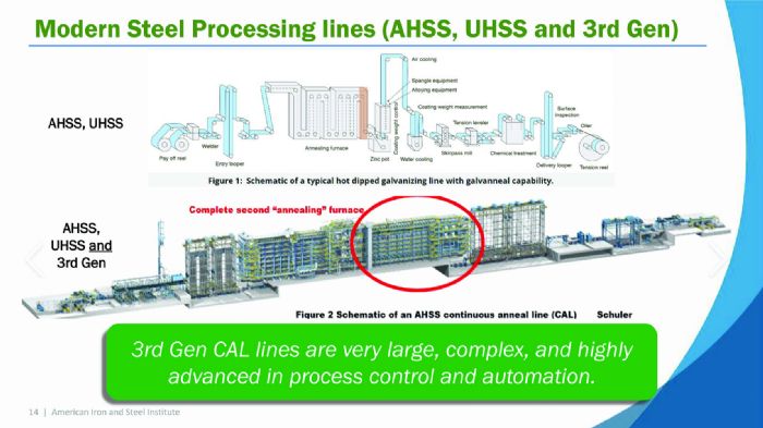

Nucor recently built new facilities and implemented new manufacturing methods, with more being built, to make a variety of new AHSS. These grades require significantly more rolling force. In turn, this requires the use of more powerful rolling mills to efficiently roll these steels to gauge. Nucor’s new specialty cold mill complex at its Arkansas sheet mill was built with a supported six-high reversing mill capable of cold-reducing AHSS steels to gauge with more force and significantly fewer passes than conventional reversing mills. Several new AHSS grades require upgraded galvanizing lines with improved heat treat capabilities to be galvanized or galvannealed. Many grades require a continuous annealing line with rapid quench capability and additional furnace capacity to attain the unique thermal processing needed to develop the desired microstructures.
Nucor recently built a new flexible galvanizing line that can operate as a continuous annealing line or a galvanizing line that can coat and heat treat the new AHSS grades, with an annual capacity of approximately 500,000 tons. Currently, Nucor is building two more galvanizing lines with this capability.
Bala Krishnan, director, global R&D, ArcelorMittal: As their names and specifications imply, the new 3rd Gen grades have higher formability at a given strength level, irrespective of whether they are hot-stamped (such as Usibor and Ductibor) or cold-stamped (such as Fortiform and multi-phase MP).

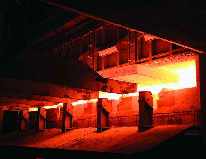

The most modern steel-making methods are the result of several process improvements. ArcelorMittal made multimillion-dollar investments in sophisticated heating processes, precise annealing, rapid quenching and controlled-cooling capabilities. In addition, steam injection, uniform coating and post treatments add versatility to these grades. These include developing pre-phosphated steel that lowers the friction coefficient to enhance material movement through the binder and improve paintabilty; special alloy coatings that double corrosion protection; and treatments that accelerate the heating rate on hot-stamped steel. This is not an all-inclusive list; other treatments are proprietary.

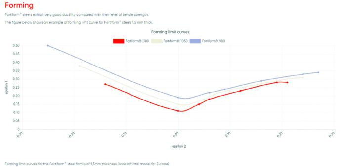

Krishnan, ArcelorMittal: Modern innovations have prioritized manufacturability as much as delivered weight savings at the best value possible. This represents a huge shift from previous generations that prioritized lightweighting exclusively, leading to manufacturability challenges.
These cold-stamped Fortiform and multi-phase MP 3rd Gen steels provide additional weight reduction thanks to their higher mechanical properties than conventional AHSS while retaining the same formability. For example, the 3rd Gen, high-formability 980-MPa steel has the same total elongation as that of the 2nd Gen 590-MPa product with good bake-hardening.

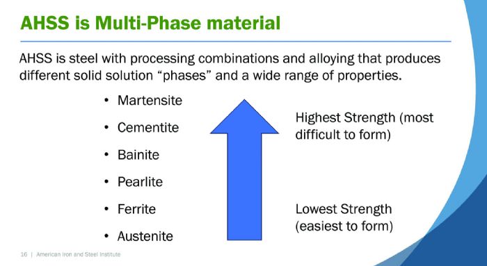

Kanelos, Nucor: Property characterizations of new Gen 3 AHSS include higher ductility at higher strength levels but also higher n-value (work hardening).
Nucor has developed several complex-phase and multiphase grades that have unique microstructures, providing excellent stretch to flanges, resistance to shear fracture and global formability. They also have excellent weldability and fatigue performance.
Chronister, Cleveland-Cliffs: Early grades of AHSS have a relatively large gap between yield and tensile strength. What does that mean? It is the inherent nature of the product to have high springback. 3rd Gen AHSS grades have low yield-to-tensile strength ratios, which improve forming characteristics while supporting load requirements in thin-gauge components. While the 3rd Gen AHSS are not as formable as an extra-deep-drawing steel, which has 40% or higher elongation, they have more than three times the strength with as much as 20% elongation.
As with other grades of AHSS, 3rd Gen steels also work-harden very rapidly during forming.

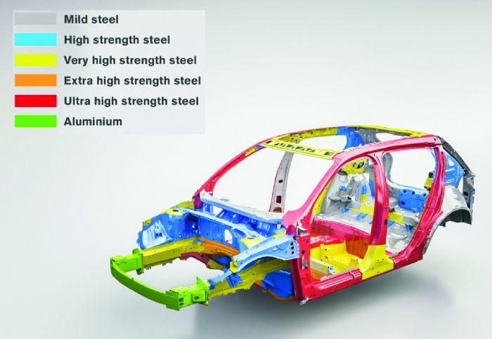

Kanelos, Nucor: The best applications for the new AHSS grades include structural chassis components such as frame and roof rails, rockers, A and B pillars, cross members, bumper beams, and EV battery-box components. This would also include control arms, engine cradles and rear cradles.
Non-automotive applications for AHSS steels have been slower to come; however, as demand for sustainability and energy efficiency increases, other markets are using some of these steels. They include heavy equipment, agricultural equipment, and Class 8 trucks and trailers.
Chronister, Cleveland-Cliffs: Many automotive applications are being redesigned with new grades for better energy absorption and intrusion protection. Examples include door rings, structural members in all areas of the vehicle and exposed items.

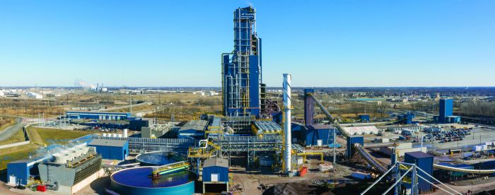

Chronister, Cleveland-Cliffs: Cleveland-Cliffs has worked to reduce carbon emissions with massive investments such as the hot-briquetted-iron-production unit in Toledo, OH; by replacing some of the coke used for iron reduction with natural gas; and by using higher scrap rates to stretch hot-metal use and reduce emissions. More efficient use of energy and generation of its own electricity or steam by using off gases for combustion also reduce the mill’s carbon footprint.
