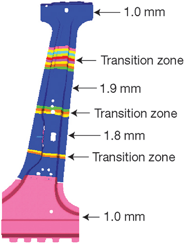

Fig. 2—This image of a B-pillar inner reinforcement, formed from a tailor rolled blank, shows regions of differing thicknesses. When extricating vehicle-crash victims, rescue crews must know which areas are easiest to cut. These areas differ with various vehicle models.

In addition to producing B-pillars from ultra-high-strength steels, some automakers save even more weight by using tailor rolled blanks. These variable-thickness blanks allow OEMs to control thickness profiles in the formed components to optimize crash response (Fig. 2). First responders must know vehicle-specific designs to ensure targeting of the thinnest areas when cutting.
