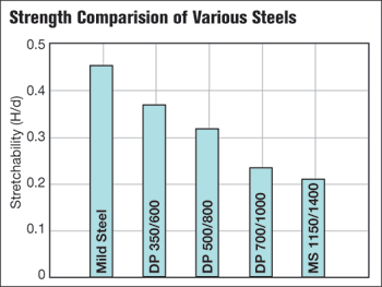

How n-Value Affects Stretchability
Fig. 2—Schematic shows reduced stretchability and increased strain-gradient severity as the n-value decreases with increased steel strength.

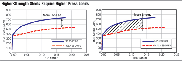

Higher-Strength steels require higher press loads
Fig. 4—Tonnage is a function of peak stress (load) but energy is a function of the entire area under the true-stress true-strain curve.
In the virtual world, however, we change the strength or other properties of the steel by simply retyping new properties into the program and clicking Run. The major benefit: evaluating the effect of the steel properties and lubrication before even starting to build the physical die. A series of entries on the keyboard cue the performance of what-if scenarios. However, even forming in the virtual world requires accurate properties of the production steel for accurate computation. Without the steel properties, every trial is simply a guess—in the virtual and in the physical worlds.

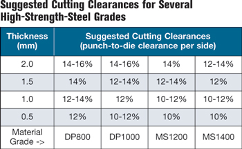

Suggested cutting clearances for several high-strength-steel grades
The higher stresses needed to penetrate stronger materials require additional cutting clearances between the punch and die as compared to those required for mild steel. The table, Suggested Cutting Clearances for Several High-Strength-Steel Grades, provides some recommended cutting clearances for several high-strength grades. Excessively tight cutting clearances often lead to increased galling and chipping. But when cutting clearances are too large, cracking may result. Plastic deformation of the tools also can occur if process stresses exceed the compressive strength of the tool steel.
