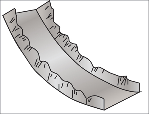

Wrinkles in a shrink flange
Fig. 3—Wrinkles in a shrink flange.

Shrink flanges in high-strength materials have a high potential for wrinkles that may not be corrected without product geometry concessions (Fig. 3).
Lastly, avoid wrinkles in shrink flanges at all costs, even if product engineering might accept them. Shrink-flange wrinkles in AHSS stampings can quickly wear out flanging tools. Add take-up beads or other geometric features to consume excess material. MF
