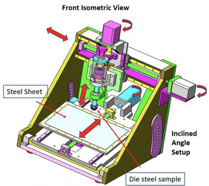

And, last but not least, in regard to die wear A/SP recently developed a sliding-wear test machine at the University of Windsor, in Canada. Designed to mimic how an AHSS sheet slides in a die, it allows researchers to evaluate die wear using any type of tool steel. The upside: enhanced continuous improvement of die materials, surface treatments and coatings. Peruse the A/SP LinkedIn page for details: www.linkedin.com/company/auto-steel-partnership/ posts/?feedView=all&viewAsMember=true.

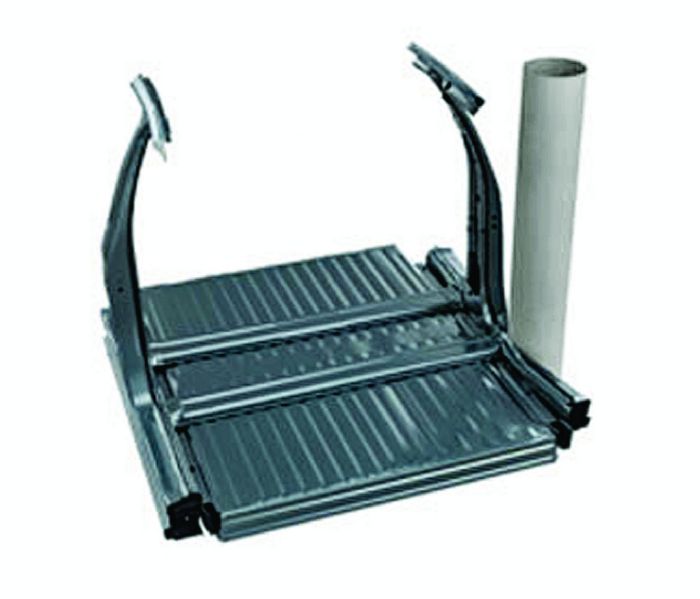

While roll formed parts traditionally had to be relatively straight sections, now we see the ability to perform true 3D roll forming allowing designers to replace welded assemblies of two or three stamped parts with one complex roll formed component. “Metal formers now can, for example, develop a roll formed section that runs from the hinge pillar up the A pillar and into the roof rail,” Davenport says, “using a 1500- or 1700-grade of martensitic steel. Such a part provides a tremendous amount of strength in a closed section with no weld joints to deal with.”
Ford provided an excellent example of this―a roll formed A pillar on the 2020 Ford Explorer―at the International Automotive Body Congress 2020 event. And, in fact, steelmaker SSAB named the use of 3D roll forming as one of its five key takeaways from the 2020 IABC. Demonstrated by Tier One supplier Shape Corp. using its 3D Sweep Forming Technology, the process can make sweeps as tight as a 400-mm radius and requires only a minimum 100-mm transition zone.
SSAB also highlighted, from IABC 2020, the use of 3D roll forming to manufacture load-carrying beams for electric-vehicle battery enclosures. The process enables the design of a space-saving enclosure that not only protects the battery pack from crash intrusions but saves space in the passenger compartment. The material of choice: SSAB’s Docol 1700 martensitic steel.
