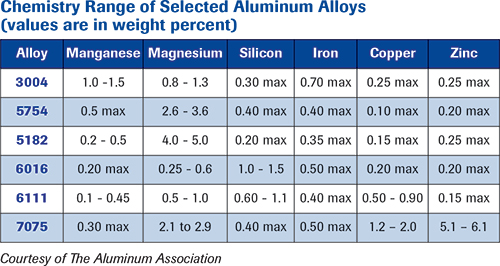

An efficient scrap-recovery system maximizes the profitability of parts formed from these grades. When collecting steel scrap for recycling, stamping plants typically send all grades into one hopper. If done with aluminum stamping scrap, a significant loss in value would result. See the table, Chemistry Range of Selected Aluminum Alloys, for composition ranges of representative aluminum alloys. Compare the magnesium and silicon levels of the two 5XXX- and the two 6XXX-series products shown for an indication of why scrap segregation is important.
We are all familiar with beverage-can recycling efforts, which work primarily because all can bodies consist of one of two grades, AA3004 or AA3104. Higher-strength alloys such as AA5182 are needed for lids, as they do not undergo the same forming process as bodies, and, therefore, do not have the opportunity to work-harden. Despite the higher magnesium content, AA5182 is considered to be recycling-compatible with AA3004/3104. Aluminum lines that melt and roll beverage-can stock typically only serve this market, and have optimized chemistry and processing accordingly. Significant quantities of scrap from other 5XXX/6XXX applications are not incorporated into the melt, since it will make the chemistry requirements of 3XXX-series can body material more difficult to achieve.
Scrap segregation takes on increasing importance for manufacturers targeting automotive applications. Engineered scrap can encompass 40 percent of large panels—consider the window cutout of doors. In preparation for the 2015 F-150 launch, Ford installed a $60-million pneumatic scrap-handling system that returned scrap aluminum back to the producer mill, creating a true closed-loop recycling process. Scrap value increased by 50 percent after segregating by grade and producer, allowing for a savings of $80 million/year and ROI within less than a year. In addition to exposed applications requiring 6XXX alloys, some companies use these products on unexposed applications as well to facilitate scrap recycling, in spite of the higher material costs as compared with 5XXX.
Automobile manufacturers have yet to specify 7XXX-series alloys for more than a few parts. When they do, separating different grades will take on even greater importance, as high levels of copper and zinc must be kept out of the recycling stream of other aluminum-alloy families. MF
