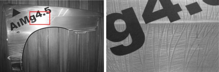

Automobile fender stampedAutomotive applications typically are limited to unexposed surfaces since they tend to form stretcher strains when cold formed (i.e., Lüders bands) and can cause poor appearance after painting (Fig. 1). The most common grades include 5182 (AlMg4.5Mn0.4), 5754 (AlMg3) and 5083 (AlMg4.5Mn0.7―used in superplastic and quick-plastic forming, as explained later).

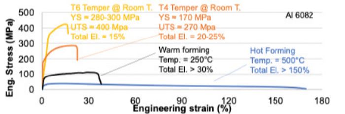

Al-6082-stress-strain-curvesAnother method used to form relatively complex and high-strength automotive components (yield strength exceeding 280 MPa/40,000 psi) with 6000-series aluminum alloys is cold forming the material in a relatively soft temper, and then applying post-form heat treatment to harden the parts. Jaguar-Land Rover began using this technique in production in 2012, and the 13th-generation Ford F-150 has 14 components produced using this technique.

Warm forming refers to forming at elevated temperatures typically between 170 and 230 C (340 to 450 F); hot forming refers to forming at temperatures exceeding 450 C. In the automotive industry, warm forming has been applied to 5000- and 7000-series alloys. For example, the 2013 Jaguar F-Type has the world’s first warm-formed Type 5182 aluminum door-inner panels, with a draw depth exceeding 165 mm (6.5 in.). And, BMW used warm forming to stamp side-impact door beams of its i8 coupe from aluminum alloy 7075-T6, one of the strongest aluminum alloys. Here, blanks were heated to 230 C (450 F) and formed into a heated die. Yield strength of the final part at room temperature falls between 400 and 480 MPa (58,000 to 70,000 psi), depending on the e-coating temperature. In warm forming of 7000-series grades, springback still could be a problem requiring part optimization and die-geometry compensation.
In most warm-forming operations, blanks are lubricated, heated and then (typically but not always) formed in heated dies. Cycle times range from 10 to 20 sec., compared to 1-2 sec. for cold forming.
Hot forming of aluminum (or hot forming and quenching, HFQ), occurs at 400 to 500 C (750 to 930 F), at which the material is solution heat treated. Automotive-parts stampers hot form 6000- and 7000-series grades because these alloys can benefit from increased strength after the final aging process. Formability can increase substantially for most grades at hot forming temperatures; total elongation might exceed 100 percent (Fig. 2 and 4), while strength may decrease to as low as 40 to 70 MPa (6000-10,000 psi). Springback is nearly negligible from hot forming, and cycle times range between 10 and 20 sec.

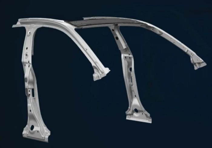

Among the automotive applications for hot formed aluminum: Alfa Romeo 4C floor panel (Type 6016 aluminum), Aston Martin DB11 A-pillar (6082-T6), Aston Martin DBX SUV (nine components, from 6082-T6, Fig. 3) and the NIO ES6 Chinese electric vehicle (seven components, from 7075-T6).

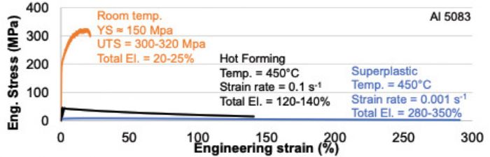

Superplastic forming (SPF), a unique version of hot forming, heats a special alloyed aluminum (mostly Type 5053 for automotive parts) in excess of 450 to 500 C (840 to 930 F). At this temperature, work hardening (as we know at room temperature) is not effective. The material hardens based on its strain-rate sensitivity. At a limited strain-rate interval, the material may undergo extreme ductility before failure: total elongation greater than 300 percent, called superplasticity.
Al-5083-stress-strain-curvesReferring to Fig. 4 showing stress-strain curves for Al 5083, at room temperature the alloy has a yield strength of approximately 150 MPa (22,000 psi) and more than 20-percent total elongation. Once the strain (deformation) rate hits the sweet spot of superplasticity, stress level may be as low as 5 to 10 MPa (7250 to 14,500 psi) and ductility may exceed 300 percent. In aerospace grades, total elongation can exceed 1000 percent.
SPF only requires one half of the die (male or female), which minimizes the fixed cost of the tooling. Forming occurs using air pressure (blow forming) to stretch-form the part without draw-in. This can result in severe thickness reductions.
