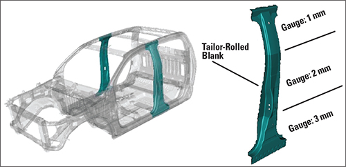

Fig. 3—The 2015 Chevrolet Colorado/GMC Canyon included a tailor-rolled (variable-thickness), hot-stamped 1500 MPa-tensile strength B-pillar.

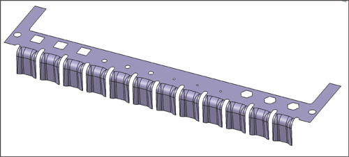

Fig. 4—The two-phase study was conducted on a progressive die operated at Richard Tool & Die Corp., New Hudson, MI, under production conditions. The 14-station die was designed to produce an experimental part (as this schematic shows) with 12 flanges of complex shape.

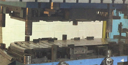

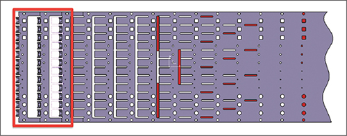

The two-phase study centered on a progressive die operated at Richard Tool & Die Corp., New Hudson, MI, under production conditions. The 14-station die produced an experimental part (Fig. 4) with 12 flanges of complex shape. The selected stamping material, bare 1.2-mm-thick DP1180 sheet, represented the most severe material challenge available today for cold-stamping applications. Fig. 5 shows the 14 progressive-die operations on the strip layout with Fig. 6 showing the die in the press during the stamping operation.

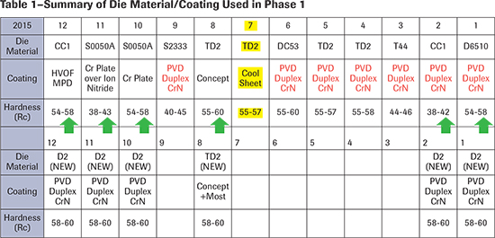

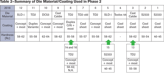

The experimental test die consisted of 31 inserts, using a combination of one of 11 die materials and one of nine surface treatments (coatings). Phase 1 of the study was conducted in 2015 using 18 die material and coating combinations currently specified for the production of AHSS parts with tensile strengths below 980 MPa (see Table 1). Phase 2 in 2016 was conducted on part material with tensile strengths greater than 980 MPa using 13 die material and coating combinations based on the results from Phase 1 (see Table 2). Die materials tested included TD2, D2, T44, CC1, D6510, DC53, S2333, S0050A, SLD-I, Toolox 44 and Cast Caldie. Coatings tested included PVD Duplex CrN, Duplex CrN and Most, CR Plate, Cool Sheet, Concept, Concept and Most, Cr Plate, Cr Plate over ion nitride, and Duplex Variantic (TiAlCN).
Fig. 5—The 14 progressive-die operations used to produce an experimental part are shown on this strip layout.

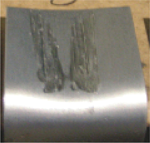

The study judged die wear based on the following criteria: safe (no damage), minor scratch marks and very rough scratch marks on the stamped part surface (Fig. 7). Every 100 hits yielded panels for evaluation. Employing die and coating materials successfully used for steels with tensile strengths less than 980 MPa, the 2015 experimental trials resulted in performance failures as early as 35 hits, and most of the inserts failed by 20,000 hits. The only combination to survive through 20,000 hits: TD2 coated with Cool Sheet (highlighted in Table 1).
Fig. 6—The progressive die, experimental tools and strip are shown in operation at Richard Tool & Die.
In 2016, the team investigated die durability of a new set of die material and coating combinations to determine applicability to forming the next generation of AHSS with tensile strengths greater than 980 MPa. In general, die-insert performance proved significantly better than in 2015. Though the study noted one failure after 4000 hits, the majority of inserts lasted more than 10,000 hits with four combinations enduring 65,800 hits. In fact, the die insert (TD2 coated with Cool Sheet) that performed best in the 2015 experiments continued to perform without major failure in the 2016 experiment, with a combined hit total of more than 80,000.
Fig. 7—This experimental part shows rough scratches, caused by a worn tool.
