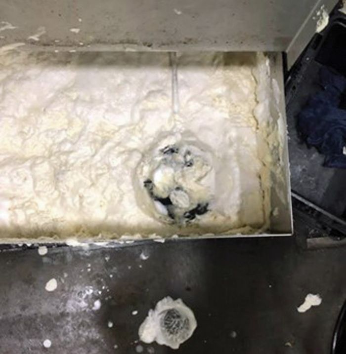

The proper use of lubrication in the pressroom can affect each of the three scopes and deliver quick and effective improvements to your ESG reporting. The emission of excess gases (Scope 1) can result directly from using the incorrect lubricant, an improper dilution ratio, excessively applied lube or inaccurate lubricant placement, which ends up burning off into the atmosphere or being hauled away as waste.
wasted lubricantIf you can’t remember when you last changed lubricants, consider meeting with your lubricant supplier to help determine the best choice for every part that you manufacture. One size often does not fit all, and the optimal lubricant and application process can vary.
If using a graphite mixture or oil-based product, consider switching to a synthetic or semisynthetic lubricant for easier disposal. This search may include establishing a dilution ratio for the lubricant that better improves the stamping process. Here, proportional mixing machines provide a productive and consistent means of creating a uniform formula. Even the process used to stir the mixture is important, as excessive agitation can degrade the lubricant.

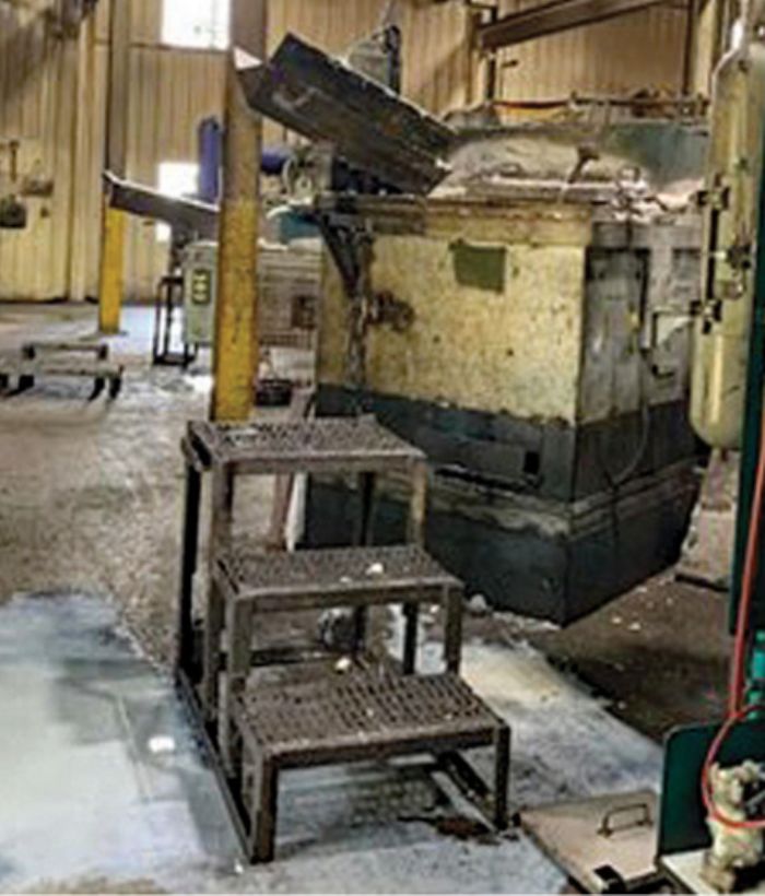

The delivery and application of lubricants also impacts Scope 1 emissions. Tour your shop floor and identify misplaced lubricant—puddles on the floor or on machinery, and excess spray in the air, for example. Making improvements in these areas can substantially reduce lube consumption and lower your carbon footprint.
