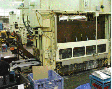

This Minster 1600-ton unit, reportedly the world’s largest two-point eccentric-shaft press, employs die doors to assist in lubrication containment and protect workers should a malfunction cause parts or scrap to fly out of the die. |
Assisting in lube containment are Pax die doors integrated into press shields as well as a system to handle lubricant mist. Because of the tremendous amount of heat generated during stamping, steam is produced when the water-soluble lubricant hits the hot progressive tooling. The steam acts as a lubricant carrier, necessitating a method to contain it, especially in situations where a component such as a conveyor exiting the press results in an open press window. To combat that, Schaller has incorporated a filtering exhaust system, also from Pax Products.
“We use it to capture any particles getting into the air,” says Pikunas. “We can do that with assistance from the die doors that help create a vacuum exhaust. As a result, we have no air-quality issues.”
Every press at Schaller incorporates die doors. The company had experimented with many different doors—homemade and purchased—trying to find doors best able to contain lubrication and protect employees. The doors from Pax have done that, says Pikunas, and their light weight has provided ease of use.
“Unlike in the past, we no longer have health and safety issues due to operators trying to lift up the doors,” he says. “Also, the doors can be locked in a number of positions so that a door can’t swing down and injure an employee.”In addition, the doors provide safer press operation.

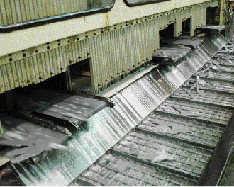

Schaller Corp. switched to low-profile conveyors such as these, bringing better control of part and scrap removal. An added benefit: The conveyors last much longer than expected in the hostile stamping environment. Note the lubricant runoff below the conveyors. Schaller captures and reclaims its lubricant, bringing a host of cost and safety benefits. |
“A limit switch must be engaged, so the door must be in a closed and set position for the press to run,” says Pikunas. “That’s a big concern to us—in the past, we’ve had an instance where a miss-hit occurred in a press and a detail flew out of the die and struck the operator.”

Another press improvement at Schaller revolves around part and scrap removal.
“In years past, we were not able to integrate conveyor operations into the press logic system,” Pikunas recalls, hampering the use of sensors in areas such as under the die where scrap would exit onto conveyor systems. “Scrap could pile up, get up into the tool and blow out our die.”
Low-profile conveyors, again from Pax, helped provide the connectivity Schaller needed.
“Sensored properly, when the conveyor stops the press will stop,” Pikunas says. “When we sensor conveyor operations, we know that the belts are moving and that scrap is exiting. With our new setup, the press stops in a certain amount of time if the conveyor belt stops moving. Then we can examine the tool and find out why.”
The conveyors also have exhibited long life in the harsh stamping environment, according to Pikunas.
“The Pax belt has provided us at least one-and-one-half times the life of a normal belt,” he says, noting that typical conveyor life is five years, and some of the Pax conveyors are going on eight years. “And whether we use the conveyors in flood or spray operations, they can withstand the excessive amount of fluid because the units are well sealed, including the motor and related components.”
