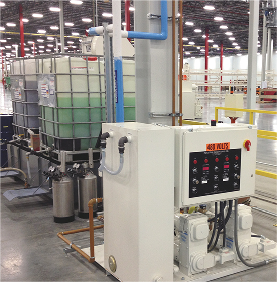

lubricant mixing method uses a venturi mixer
The simplest lubricant mixing method uses a venturi mixer, where water flow creates suction and pulls the lubricant concentrate into the water flow. Downsides: Ratio of water to lubricant can vary, and it won’t work with more viscous fluids.
Several methods ensure a consistent mixture of stamping fluids. Check the concentration of the lubricants daily—no different than verifying material thickness or critical part dimensions. The mixing process should employ a mixing system and not be performed manually.
Stampers can choose from a variety of mixing options. The simplest method uses a venturi mixer, where water flow creates suction and pulls the lubricant concentrate into the water flow. The downside to this method: The ratio of water to lubricant can vary slightly due to water pressure, lubricant viscosity and lubricant fluid level in the drum or tote. To adjust the concentration, a plug or orifice must be changed out, so a mixer is best set for one dilution. Should a second dilution be required, use a second mixer. Also, these simple mixers cannot create a strong enough venturi action with more viscous fluids.

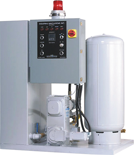

For improved performance, use a positive-displacement mixing pump, which can handle more viscous lubricants. In these types of mixers, water pressure drives a piston that pulls the proper amount of lubricant and combines it with water to provide a much tighter tolerance on the concentration. To adjust concentration, simply turn the piston to a longer stroke, injecting more lubricant into the water flow. Because all adjustments using this method are performed manually, human error can play a part.
To remove the human element and other variation, a programmable, proportional mixing system will provide a consistent ratio with the touch of a button. These systems can be used as stand-alone mixers, supplying a single dilution or two dilutions. They can be changed easily and locked out for adjustment only by proper plant personnel. Another advantage, proportional mixing systems can connect to a plant distribution system easily, and incorporated into a pressurized delivery system for each stamping press or individual dies.

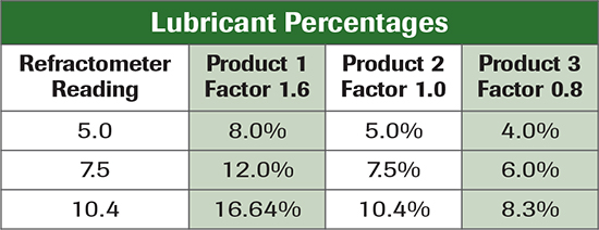

Lubricant PercentagesOnce mixed, fluid often is not checked for the proper ratio of lubricant to water. Your lubricant supplier should provide a target range for the optimal performance of a specific stamping fluid. Some plants decide to run at one concentration for the entire manufacturing process, while others find that one lubricant with two ratios work best—one for tougher work, and one for light- to medium-duty jobs. Daily checks of the mix ratio are critical; use check sheets to capture the concentration for each press or workcell.

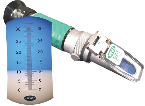

Handheld or digital refractometers provide accurate readings of the process fluids. Here, a small amount of the lubricant mixture placed on the device delivers a visual reading on a scale or a displayed number that is unique for each product used. The number does not represent the percentage of stamping lubricant to water—a common misconception—but is a number that must be compared to that specific lubricant to determine the actual percentage.
 programmable, proportional lubicant mixing system
To remove the human element and other variation, a programmable, proportional lubricant mixing system will provide a consistent ratio at the touch of a button.
The formula to determine the actual ratio of lubricant and water:
Refractive Index x Product Factor = Lubricant Percentage
For example, a stamping lubricant with a product factor of 1.6. that gives a reading of 10.0 yields a lubricant percentage of 16 percent. Your lubricant supplier can provide a technical datasheet that gives the product factor. The only time that the refractometer reading reports the true percentage is when the product factor is 1.0 (see Lubricant Percentages chart above).

Refractometers give accurate readings of the process fluids
Refractometers give accurate readings of the process fluids, leading to proper calculation of lubricant-to-water ratios.

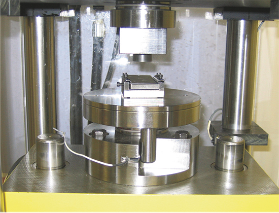

Scientific laboratory tests also provide a real-world lubricant comparison. For example, the twist compression test uses a rotating tool-steel cylinder and a material coupon, along with a hydraulic force, to measure friction and provide a lubricant comparison. Pressures and speeds can be adjusted to mimic the stamping process. The test does not simulate the actual stamping processes, but the results derived correlate well with fieldtesting performed on actual stamping dies. This preliminary testing can give confidence to proceed with the trial, offering knowledge that failures will be minimized or eliminated.
Commonly used in lubricant trials, the twist compression test uses a rotating tool-steel cylinder and a material coupon, along with a hydraulic force, to measure friction and provide a lubricant comparison. Pressures and speeds can be adjusted to mimic the stamping process.
