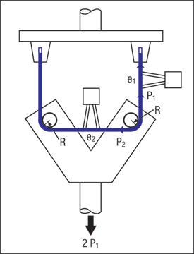

Fig. 4 The punch radius friction test
Fig. 4—The Punch Radius Friction test uses extensometers on two legs of the U-shaped specimen for computing the coefficient of friction around the radius R.

The Punch Radius test simulates sheetmetal sliding around the radius between a flat bottom cup and a vertical wall (Fig. 4). Strip motion is slow compared to the DBS and BUT tests.
