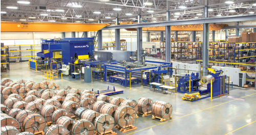

| A new forming line at the York, PA, facility of GEA PHE Systems employs hydraulic-press technology containing many small cylinders rather than one large one, to achieve full force. The small cylinders fill faster and require substantially less compressible oil compared to a press with a large cylinder and longer stroke, resulting in much faster cycle time and higher output. |

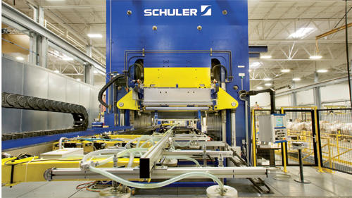

To gain productivity and maintain precise material control throughout the forming process to produce the heat exchangers, the company has employed a new short-stroke multi-cylinder hydraulic press from Schuler Inc., Canton, MI.

Schuler responded with a concept for a custom hydraulic-press system featuring a short-stroke, multi-cylinder design. This approach allows precise material flow with high final quality—no wrinkles or defects, according to Schuler officials.
| The new hydraulic-press system at GEA PHE Systems includes a decoiling line with shear, automatic feeding with a single-rail shuttle into the embossing press and a die-change cart able to simultaneously handle three dies. A single-rail shuttle removes formed plate from the embossing press and transports it to a blanking press. The exit side of the blanking press features gantry-type automation to remove and stack the plates. |
The system—Schuler engineered, manufactured, delivered and installed it as a turnkey project—includes a decoiling line with a shear, automatic feeding with a single-rail shuttle into the embossing press and a die-change cart able to simultaneously handle three dies, allowing complete die change in less than 30 min. It also includes a single-rail shuttle that removes formed plate from the embossing press and transports it to a blanking press. The exit side of the blanking press features gantry-type automation to remove and stack the plates.
The press employs many small cylinders rather than one large one, to achieve full force. The small cylinders fill faster and require substantially less compressible oil compared to a press with a large cylinder and longer stroke, resulting in much faster cycle time and higher output. Repair time and expense also are greatly reduced compared to what a large-cylinder design would require, say Schuler officials.
In addition, the multi-cylinder design allows GEA PHE Systems to make heat-exchanger plates in a variety of sizes, providing the flexibility to meet changing production needs and customer demand. The company now produces as many as four parts/min., with one operator handling the entire process. For the 28,000 tons of force provided by the press, the output rate is believed to be one of the best in this industry, add Schuler officials.
