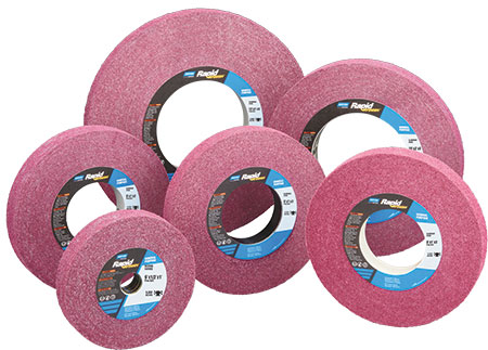

Density concerns the amount of bonding agents and abrasive grain compressed into the product. While softer densities offer improved conformability to work surfaces and less tendency to burn a workpiece, harder densities in general cut faster, last longer and provide finer finishes.
Non-woven convolute wheels, made by wrapping non-woven material around a center core and bonding together the layers, can easily be shaped to match preformed parts.

Much of the information above is contained in typical specification listings for non-woven abrasive products. For example, you may see the following specification:
8 A/O MED, where
8 = density, which can range from 2 (open/most conformable) to 9 (densest/most durable)
A/O = the abrasive used (A or A/O refers to aluminum oxide)
MED = grit size (medium, 100 to 150 grit)
