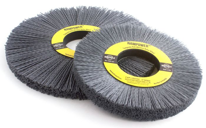

1-Brush-Research-Finishing-productThe abrasive-filled nylon filaments are set into molded cores, allowing higher filament densities and putting more cutting tips at the point of attack, according to company officials, who note that the durable, self-sharpening filaments provide excellent wear life.
Tested extensively in the lab: a 6-in.-dia. tool with silicon-carbide filaments that can be automated via attachment to CNC equipment or employed offline in a secondary operation. JR Precision & Welding opted for 80 grit to provide the desired surface finish. The tool fit well in the magazine of the shop’s five-axis machine and existing toolholders, according to Mawazeb, who noted the tool’s exceptional performance. In addition to removing the large burrs, he offers, the brush also provided a soft edge break to the muzzle cylinder’s four ports, removing the razor sharpness without affecting the surface finish.
“The abrasive nylon brush removes just the right amount of material,” says Mawazeb, “and the surface finish  matched what the customer wanted.”
With the concept proven, JR Precision & Welding ultimately decided to purchase a smaller 3-in.-dia. version of the wheel brush. This brush’s shorter trim fill has less give, thus delivering a more aggressive action.
