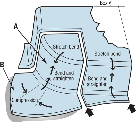

The corners in box-shaped geometries form similarly to cup drawing. If the four straight walls of the box are removed so that the corners join together, they form a cylindrical cup. These corners are compressive on the workpiece material moving toward the die radius, and tensile on the material drawn over the radius (see the figure). As a result, thickening occurs in the vertical wall (A) and the flange remaining on the draw pad (B) near the draw corners.
This thickening phenomenon sometimes is overlooked during CNC programming and machining. Worse yet, the condition may not be identified.

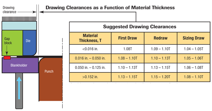

A table may be used to determine the die clearances for drawn corners.
To reduce the likelihood of galling in drawn corners, additional punch-to-die clearance must be machined in the vertical wall area. This may sound easy, but it generally requires analytical tools such as computer simulation. A properly executed metalforming simulation can provide accurate thickness plots in drawn parts, which can be used to assess material thickening locations and determine the correct clearance needed for a particular process. In the absence of this data, stampers can use tables found in die-design handbooks.
