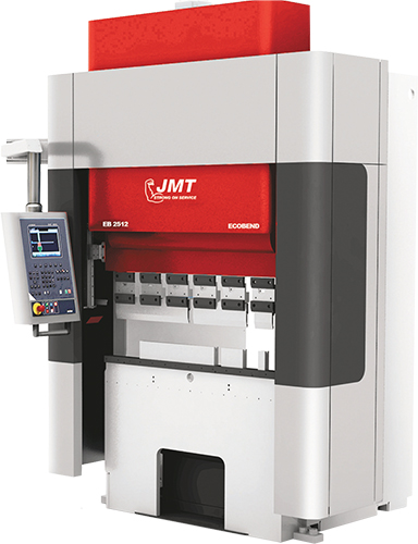

Today's hydraulic press brakes--with their programmable tooling and user-interface technologies--are more advanced than ever, but regular care remains a requirement for long life.
Having and following a plan is a sound practice when it comes to taking care of your press brake’s mechanical and electrical systems, hydraulic circuit, and tooling. Here, then, are some simple steps to follow.
