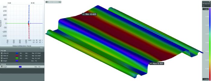

AHSS_Draw_Comparison_With_StakeBead-2_RamTonnageWith simulation only performing as well as the quality of inputs, improper assessment of material—or material that falls out of requirements in various parts of a coil—makes AHSS applications even more challenging.

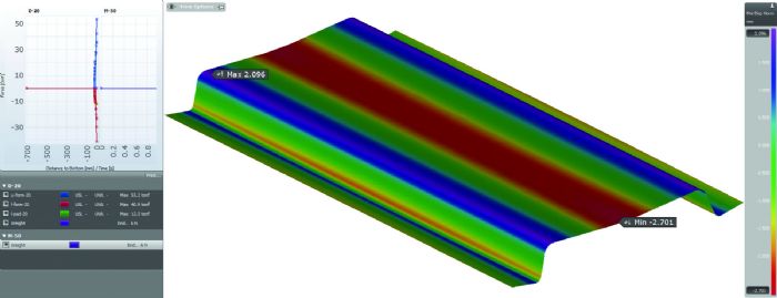

AHSS_Draw_Comparison_Without_StakeBead-2_RamTonnageFor those responsible for die tryout, the team offers, that may mean paying more money for expedited orders and the need to upgrade to more-refined material. Here again, this may be the only choice.

Through this feedback and the ever-improving nature of simulation software, Die Cad has learned via draw applications with some of its stamping and die-build customers the importance of lock-bead construction to assist with forming action. This helps in providing extra tension or stretch at the end of a press stroke, given the difficulty in trying to get any pull on the hard AHSS.
However, features such as lock-bead construction result in added scrap, which increase material usage. Tool shops and stampers, the Die Cad team explains, face difficulties in these cases, as they must stay competitive with piece prices even though the process to properly make a part requires additional material for stretching, forming and retrimming that was not orginally quoted for.

And, in the past few years simulation software has developed modules that help address press deflection, in part caused by higher pressure-pad forces required for forming AHSS, according to the Die Cad team.
One project involved such a scenario. The amount of die-pad deflection on very thick material stock deflected a 6-in. binder so much that the part would not form as expected. The solution involved re-engineering to allow for that press deflection. A simulation-software module shows the deflection, with Die Cad adding in thicker plates and seeing how much they deflect in order to limit press deflection. Shut height can’t be expanded, and the die plates that nitrogen cylinders hit against can’t be any thicker. Thus designers are pushing the comfort levels as to the amount of pressure applied to a 2-in.-thick die plate, for example.
