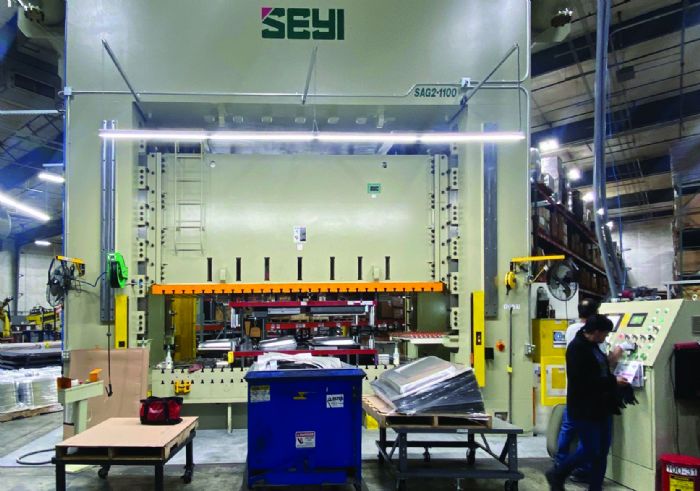

Another important requirement was related to press setup, Wunsch says. “We wanted a removable bolster. That created some challenges when it came to passline heights. So, we needed a customized line to support 16 in. of total passline-height travel in the feeder adjustment.”

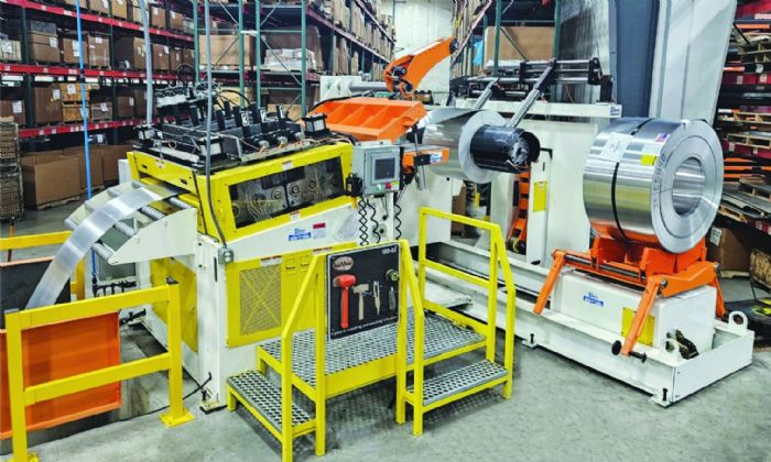

In March 2024, the company installed a Dallas Industries fully automated, 60-in.-wide conventional line with a DRFH-860 servo feed, an alligator peeler/threader, coil restrictor, a DPS-4-7-60 powered straightener and a 30,000-lb.-capacity reel with load car. For simplified setup, the unit incorporates an adjustable feeder passline height, and automated adjustment of edge guides and coil guide rolls for coil centering. The settings for these axes store in a job recipe called AutoSet.
The line is built on an Allen-Bradley, Ethernet-based control architecture and is equipped with a SyncLoop control that synchronizes the feeder and straightener speeds. The Dallas ProfileSelect feed control employs a cam-motion (sinusoidal) profile designed for a feed motion that uses 100% of the press-feed window, reducing stress on the material and the feed’s mechanical components.
“Our recent investment in the new feed line also was driven by safety concerns,” says vice president Cristofer Muchowski. “There is no price that is off limits to us when it comes to our operators’ safety. The holddown/holdup arms, everything to control that coil, expansion of that mandrel … we really asked for some custom features to ensure that we can support all of the coils that we get from our suppliers. All of the sensoring and safety controls in place are very specific to our needs to ensure our operators are safe. There’s a brake control that was a special edition, so that if we lose power to the line, the material will not push forward or fall back out of the die and put our operators at risk.”

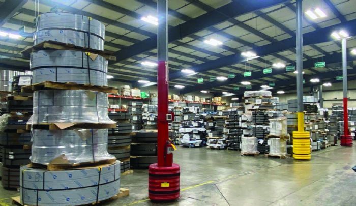

Coil storage. One way that Manitowoc meets volume demands is to store ample coil—more than the typical JIT stock. “You can’t start a recovery plan if you don’t have raw material,” Wunsch says. “Typically we house about 6 weeks-worth of material so that we can guarantee customer needs.”

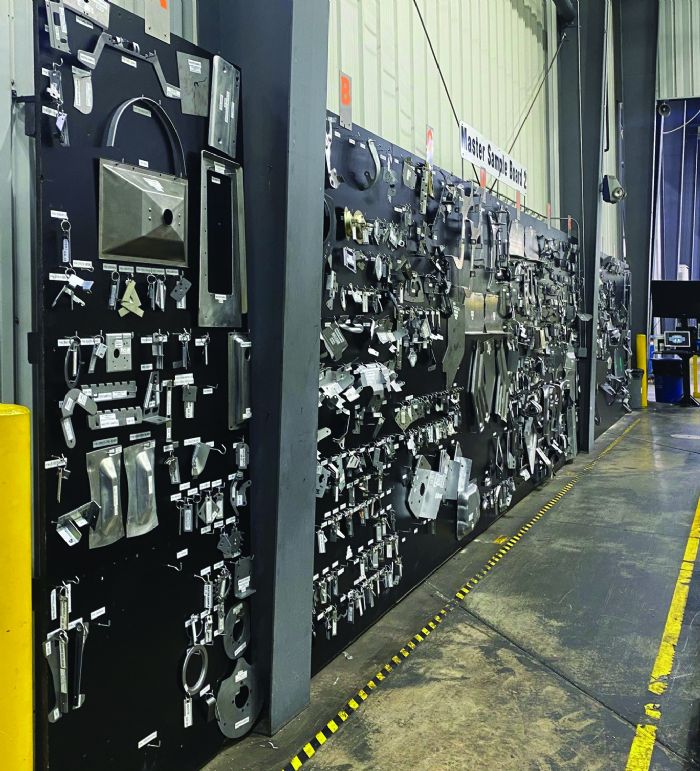

Manitowoc’s trophy case is a “sample wall” showcasing its diverse stampings—evidence of its flexibility and range of capabilities. “If any of our customers question what we’re capable of, here you go,” Wunsch says, pointing to the wall display. “If you want a flat blank with some welded nuts on it, we can do that. You want a cosmetic contoured part? We can do that, too. You want the heavy clunker? We’ve got that one, too. We do everything.” MF
