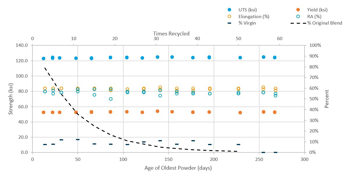

The dotted line in Fig. 1 represents the amount of powder originally loaded into the machine. So, at build one we have 100 percent of the powder, and at build 30 only 5 percent of the original powder remained in machine for the build.

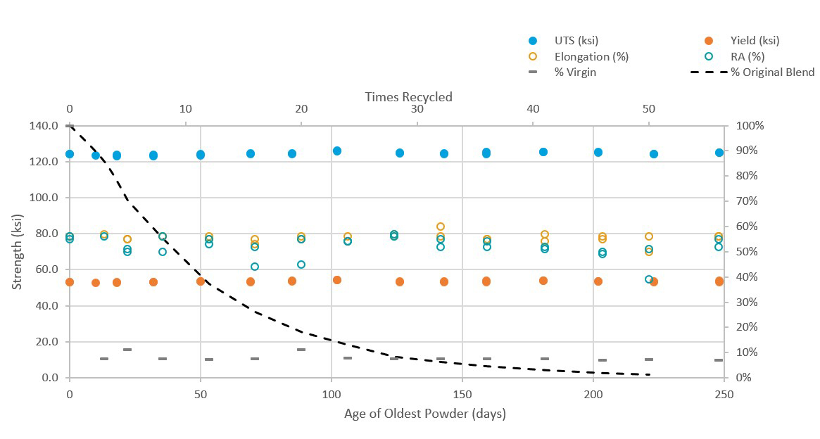

Fig. 2 illustrates the actual composition across one machine over the length of the production program. The X axis shows powder age in days, meaning that the program ran for 250 days. On top, you’ll see the times recycled, up to 55 times. The dashes at the bottom indicate the amount of virgin material added to the recycled material.
Fig. 3 provides room-temperature tensile properties added to Fig. 2, including ultimate tensile strength (UTS), yield strength (YS), elongation and reduction of area. The data maintains consistency across the length of the production of the machine.
