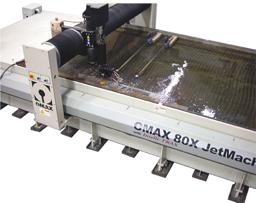

CSM’s new Omax 80X JetMachining Center bridge-style machine is equipped with a 50-hp pump, linear-drive motion system, Tilt-A-Jet cutting head and a 180 by 90-in. worktable with an 8-in. Z axis. |

An example of such a recent project: cutting, forming and assembling a wood-pulp mixer for a Cellophane plant. The project represents a full week’s worth of waterjet cutting, no problem for CSM’s new Omax 80X JetMachining Center bridge-style machine —equipped with 50-hp pump, linear-drive motion system, Tilt-A-Jet cutting head and a 180 by 90-in. worktable with an 8-in. Z axis.

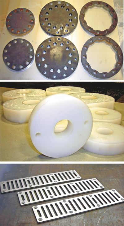

CSM consistently processes 3⁄4- to 1.5-in.-thick steel on the JetMachining Center. It’s also cut 2.5-in, UHMW plastic (top right) and even fiberglass floor grating on the machine, as well as tile, concrete and glass. Also shown here are 1⁄4-in.-thick floor-drain grates (above), with countersunk holes beveled on the waterjet machine using the five-axis head. |

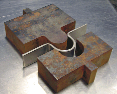

Brewer then describes a somewhat unique application for the 80X JetMachining Center: cutting 1.5-in.-thick steel plate to fabricate custom press-brake dies that CSM will use to form some of the Hastelloy into saddle brackets.
“Being able to fabricate our own, unique press-brake dies has been a big benefit since adding the waterjet machine,” he says. “We can make our own tooling rather than going outside, to ensure short lead times.”

CSM consistently processes 3⁄4- to 1.5-in.-thick material on the JetMachining Center. It’s also cut 2.5-in, UHMW plastic and even fiberglass floor grating on the machine, as well as tile, concrete and glass.

A somewhat unique application for the 80X JetMachining Center: cutting 1.5-in.-thick steel plate to fabricate custom press-brake dies that CSM uses to form Hastelloy blanks, shown, into saddle brackets. |
As far as continuing to grow the application of five-axis cutting, Brewer says that he continues to learn new ways to program the machine in order to better optimize its five-axis capabilities. He has, though, learned plenty in less than one year of operating the JetMachining Center. Among the most important lessons learned: developing a process to avoid cutting-head collisions resulting from wavy material, which initially led to shortened consumable life.
“Omax does have a solution for that issue—its Terrain Follower,” says Brewer. “And, we may invest in that technology down the road. For now, I’ve devised a procedure to inspect the workpiece material at several locations as it sits on the cutting table awaiting processing. We’ve found creative ways to hold down the material and keep it flat during cutting. And we make sure to set the cutting-head standoff distance appropriately to avoid collisions and prevent damage to the mixing tube.”
The Omax Terrain Follower, according to Omax literature, directly attaches to the Omax A-Jet cutting head. A high-resolution magnetic encoder senses changes in material height to trigger adjustments in nozzle standoff to avoid contact with the workpiece surface and protect the nozzle and related hardware. Ideal applications are when cutting large parts on uneven or warped sheets, as sometimes is the case at CSM, as well as when cutting materials that stress-relieve and warp during cutting.
“We experience the warping issue typically on material 3⁄8 in. and thicker,” says Brewer. “Then, on thinner workpieces, we’ve learned where to place clamps and weights to hold down the sheet during cutting, without interfering with the waterjet. The goal always is to reduce setup time while minimizing scrap.” MF
