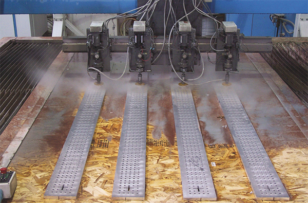

Fig. 1—Metalformers operating waterjet-cutting machines must monitor, among other machine characteristics, mixing-chamber condition. A worn mixing chamber will create a vacuum that will vary the abrasive rate from optimum. Als try to keep the abrasive rate at the parabolic peak, illustrated here. |

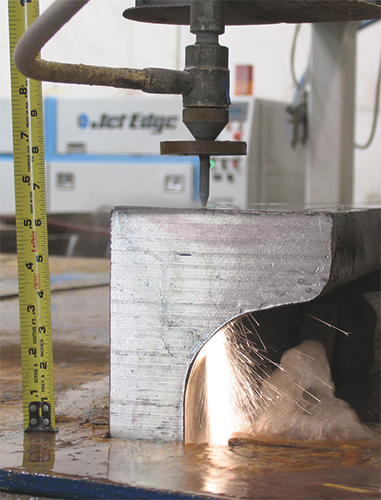

Fig. 2—When cutting test parts to evaluate process parameters, be sure to demonstrate every scenario: inside squares, outside corners, inside radius, outside radius and kerf cuts. |

Regardless of the orifice type selected, metalformers must take care to monitor the condition of the orifice, nozzle and mixing chamber. Says Schwartz:
“Take note if the feed rate used to produce good parts dips below 100 percent. It’s best to verify orifice quality by removing the nozzle and mixing chamber and inspecting the quality of the waterjet stream as it shoots through the cutting-head body. Nozzle wear is seen as rifling down the bore, when the wear pattern becomes obround.
“Mixing-chamber wear is critical as well,” continues Schwartz. “While the orifice and nozzle may be new, a worn mixing chamber will create a vacuum that affects the abrasive rate. Als try to keep the abrasive rate at the parabolic peak (Fig. 1).”

Tip 10: Cut a Test Part
“Metalformers that take the time to cut test parts, particularly when fabricating a new material type or thickness, will save time and material in the long run,” summarizes Schwartz. “Cut a part, measure it and make an educated decision on cutting parameters. We recommend cutting test parts that demonstrate every scenario: inside squares, outside corners, inside radius, outside radius and kerf cuts where you would adjust cutting speed from slow to fast for kerf angle (Fig. 2).”
