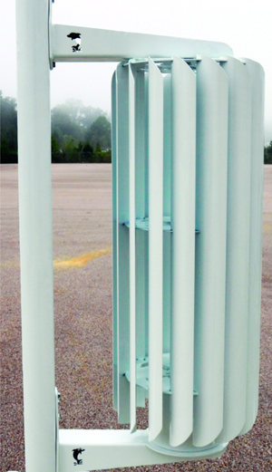

When wind-turbine manufacturer Kronos Energy Solutions, Cordova, TN, sought to improve its own level of green-fabricating processes, it turned to waterjet cutting to take on a portion of its production, custom and prototyping work. Kronos designs and manufactures small vertical-axis turbines. Company president and CEO John Bogensberger launched Kronos in 2009; prior to that, he worked for a high-production manufacturing company fabricating primarily sheetmetal. “I first saw waterjet-cutting machines at an IMTS show in 1998,” Bogensberger says. “I was intrigued with the process because it produced no toxic gases, dust nor dangerous chemicals. But I felt I couldn’t justify the machines in a high-production environment cutting sheetmetal.”
Kronos Energy Solutions vertical axis turbines
Kronos Energy Solutions designs and manufactures small vertical-axis turbines. Company president and CEO John Bogensberger launched Kronos in 2009, initially outsourcing fabrication work such as oxyfuel cutting of turbine components.
When Bogensberger launched Kronos Energy Solutions, he outsourced most fabrication work, including oxyfuel cutting (OFC) of turbine parts. Outsourcing, he felt, offered a cost-effective for his new company to have parts cut and machined without the upfront capital investment. However, outsourcing can cause production delays, particularly when design changes occur. And, Bogensberger found that the secondary processing required to remove the heat-affected zone and dross caused by the OFC process was time consuming, as was deburring of stamped parts. He decided to outsource cutting work to a shop using waterjet-cutting machines, which eliminated the need for secondary processing. “However, there still was taper to contend with,” says Bogensberger. “We use a specialized gear configuration in the wind turbines that requires very tight tolerances and required secondary machining of the waterjet-cut parts.”

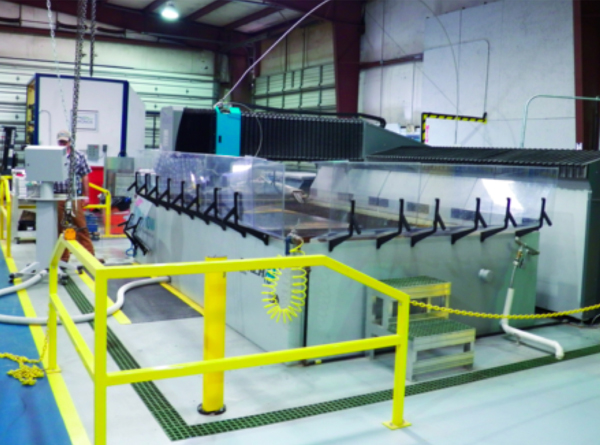

Since Kronos installed this Mach 4 FlowJet waterjet-cutting system—outfitted with a 13- by 6.5-ft. table—costs compared to outsourcing work have reduced dramatically, allowing the company to pass savings directly onto its customers.
Stream lag—evidenced by the exit point of the waterjet lagging behind the entrance point—causes geometry errors as it sweeps out cone shapes instead of circles, and causes corner wash-out on inside corners. And, V-shaped taper naturally occurs as the power of the waterjet dissipates during cutting. The faster the cutting speed the greater the kerf-taper error, which can be as much as 0.01 in. per side. As with stream lag, slowing cutting speed will minimize taper, but will restrict productivity and increase garnet consumption per inch of cut.
Flow’s Dynamic Waterjet with Active Tolerance Control avoids taper and stream lag during flat-stock cutting, says the company, maximizing cutting speed. The technology combines control software with precision machine-tool design and an articulated end-of-arm wrist.
Ownership Has its Advantages
Since Kronos installed its Mach 4 FlowJet waterjet-cutting system, outfitted with a 13- by 6.5-ft. table, costs compared to outsourcing its cutting work have reduced dramatically. “For example,” says Bogensberger, “we had previously outsourced work to a gear manufacturer at a cost of $103.00 per gear. With our FlowJet, cutting the same gear now costs about $1.40, without the need for any secondary machining. That’s savings we can pass directly onto the customer.”
