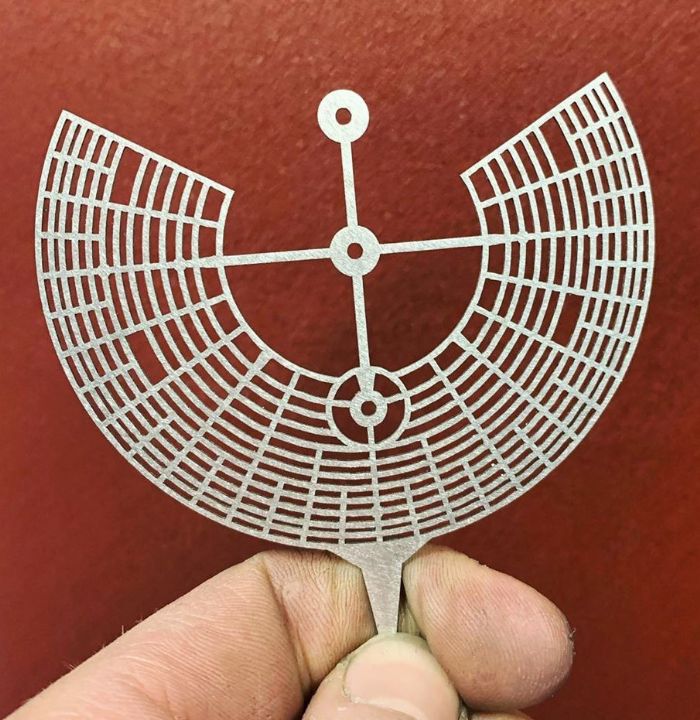

6. Space parts based on material thickness.
Laser cutting machines can’t pass over the same place twice without creating accuracy issues. Therefore, take care to avoid overlapping or intersecting lines when designing 2D shapes. Separate each object placed on the nest for cutting according to the material thickness, to ensure a reliabile cutting process. More complex and overlapping designs can be combined during assembly.
Today's lasers and sensors allow nesting wth distance between cut edges of as little as one-fourth of the material thickness. At SendCutSend, we typically space parts at least 1X the material thickness apart.

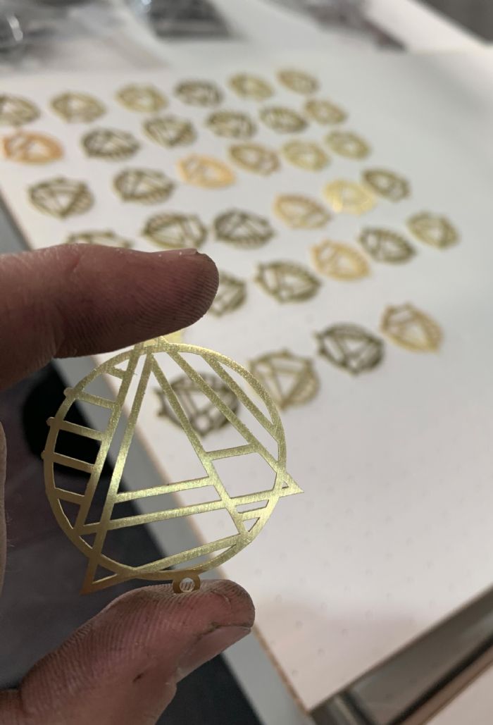

laser-cutting-interior-geometry7. Connect all shapes to the primary design.
Parts separated from the main nest, called orphan parts, will be lost if not bridged. The only exception to this rule is when the nest includes holes, which the laser can complete separately from the primary cut. The rest of the design should be bridged so that the laser can cut it in its entirety without losing parts.

10. Ensure interior geometry is at least 1x material thickness.
Holes or interior geometry smaller than the base-material thickness can be challenging to accurately and repeatedly laser cut, because the cutting process starts with a pierce that requires a certain diameter allowance.
