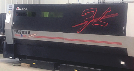

A 4-yr., $4-million expansion at Anderson, IN-based CB Fabricating included these Amada NT Laser Flex Cell CO2-laser and Ensis 3015 AJ fiber-laser cutting machines.

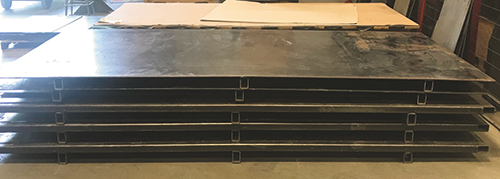

CB Fabricating fashions its own stackable 60- by 12- by 5-in. cutting tables, which make for easy transport by forklift.

The Ensis AJ 3015 AJ fiber laser runs, on average, three times faster than a CO2 laser. The newer technology uses a thin, high-energy-density beam to cut thin materials at high speed while retaining the ability to cut ferrous steel to 1-in. thick. Its variable-beam-control technology also automatically and continuously matches material thickness, providing clean, consistent cuts requiring less finish work, further improving production-turnaround times.
Strategic Cutting
Having two different cutting machines—CO2 and fiber—allows for faster throughput of light and heavy parts. “We were running one job at 236 in./min on the CO2. By switching to the fiber, we were able to run the same job at 1600 in./min. Therefore, we moved the heavy-plate jobs for automotive and trucking onto the CO2, and the thinner parts—a lot of 0.090-in. and 1⁄8-in. aluminum—to the fiber,” Barkdull says.
Another example of where the fiber excels comes in the form of 1⁄2-in.-square industrial parts. Perforated 24 by 60-in. sheets of 0.090-in. or 1⁄8-in. aluminum, with 360 squares to a sheet, run three to four times faster on the laser, with no heat buildup and excellent cut quality.
“With the turrets,” says Barkdull, “a lot of times we were shearing, but now we can load full sheets on the laser, cut, go home for the night and then come back the next day and we’re ready to brake parts out from the sheets and form. Instead of having two people running the shear, this frees up the turret for other things. The fiber is so much quicker, if someone drops off material and needs parts tomorrow, we can do that.”

While the lasers have brought a high level of automation to CB Fabricating, when it comes to moving ancillary equipment and moving parts, “we’re still a manual shop,” says Barkdull. The company fashions its own stackable 60-in.-wide by 12-in.-long by 5-in.-high laser tables, which, says Barkdull, make for easy transport by forklift.
