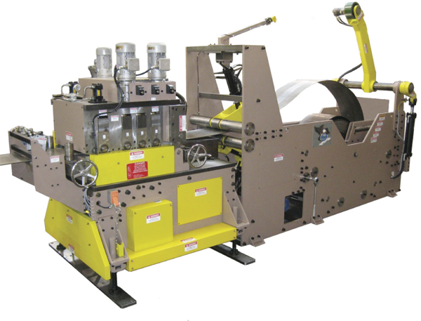

Manufacturers offer coil cradles in three basic configurations. A combination cradle/straightener (Fig. 1) unwinds the coil off of the top to a powered straightener and into a horizontal loop. Of the three configurations, this style requires the greatest amount of floor space due to the horizontal loop, but lends itself well to quick coil changes with the addition of a spare coil load ramp and an unobstructed rear loading area.

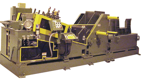

The third type of cradle—a cradle-feeder straightener (CFS)—unwinds, straightens and feeds directly into the press without the need for a slack loop, making it a very compact and self-contained coil-feeding system (Fig. 2). A CFS typically receives power from one or more closed-loop servo drives, and pays off from the bottom or top of the coil. This style provides the same advantages as the inline style, but allows the use of a loading ramp for quick coil changes. Because this style requires that coil feeding start and stop in unison with the feed motion, a CFS requires significantly more horsepower than the other cradle styles, which feed into a slack loop and unwind in a continuous operation.
Due to the vastly increased load, a CFS typically is limited to slower-speed applications, and may prove more costly than the other cradle styles due to the use of high-power servo drives. Additionally, the CFS concept generally is not recommended for use with long progressive dies, since a CFS does not allow for an effective pilot release unless the entire straightener bank is piloted.

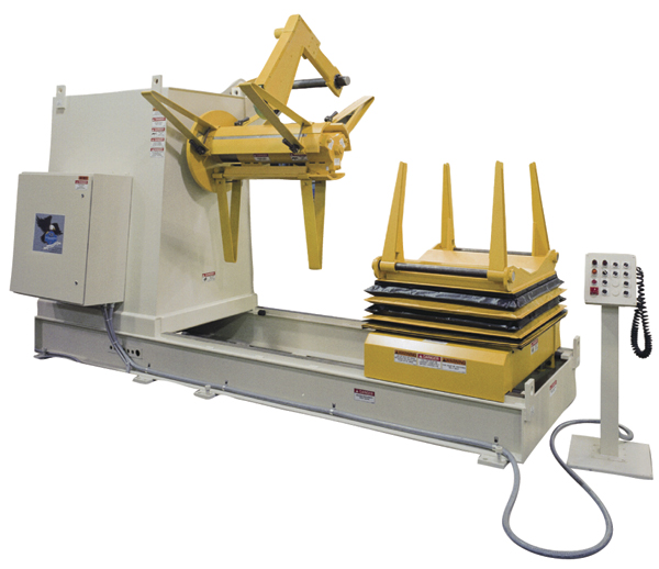

Nonpowered reels, also known as pull-off reels (Fig. 3), typically feature only a small fixed-speed threading drive or, in some cases with smaller coils or light gauge material, no drive at all. Pull-off reels rely on a power straightener or a set of pinch rolls to pull the material off of the coil during automatic operation. These reels typically feature a drag-tensioning device to maintain back tension, preventing loop slack and material distortion.
Reels come in numerous configurations, the most common being a single-mandrel cantilevered style. These typically are offered in capacities from 500 to 60,000 lb., in widths to 78 in. Metalformers can opt for stationary or traveling models—a traveling reel can quickly be repositioned upon detection of misalignment.

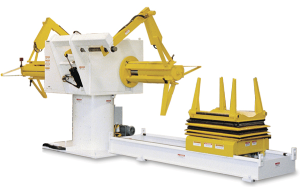

Another version of the coil-reel concept is the double-ended version (Fig. 4), featuring two mandrels facing in opposite directions, with a rotating head. This style suits applications requiring quick coil changes, since the empty mandrel can be reloaded with a fresh coil while the other mandrel runs. With the addition of dual-holddown arms, double-ended reels also gain favor for running partial coils.
