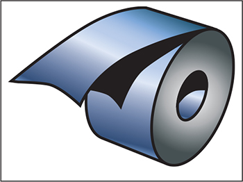

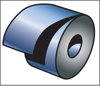

Coil set occurs during coil winding, which compresses the inside surface of the material and places the outside surface in tension, causing it to stretch slightly. As a result, the inside of the sheet ends up shorter than the outside. Cross bow (Fig. 2)—when one side of the material is shorter than the other side as measured across the width of the coil—can result from the coil-slitting process.
The number of rolls in a straightening machine correlates to the number of yielding strains (bends) it can produce, which then determines the extent of possible coil correction. Close-center straighteners can have as few as nine working rolls and as many as 21. Rolls are spaced much closer together compared to flatteners, and additional supporting rollers serve as backup rolls. Close-center straighteners can induce more yielding strains than flatteners, allowing them to better-work AHSS materials and also correct cross bow.
