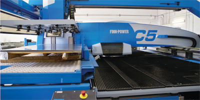

To gain the sheet capacity it needed along with the required level of material-handling automation, A-G Body purchased a model C5 Compact Express hydraulic CNC turret press from Finn-Power, Arlington Heights, IL (now Prima Finn-Power North America). The machine, with 33 tons of punching force and a nibbling speed of 1100 hits/min. (on 1-mm centers), handles sheet to 50 by 100 in. Combined with its automatic loading/unloading system, the machine’s total footprint measures a tight 20 by 24.6 ft. “With the addition of the C5 Compact Express, we have been able to bring back inhouse all of our outsourced sheetmetal work,” says Gianelo, “and we still have capacity to run more production through the machine.”
The new turret press brought other new capabilities to the A-G Body sheetmetal-fabrication shop, which Briggs and his team quickly leveraged. One example is the machine’s large work chute, capable of offloading parts to 20-in. square. Now, rather than having to keep parts nested in sheet blanks until an operator can “shake and break” the parts loose, A-G programs the press to separate parts that will fit through the work chute. A conveyor underneath the press moves the parts up and out to a parts bin, dramatically improving productivity.
