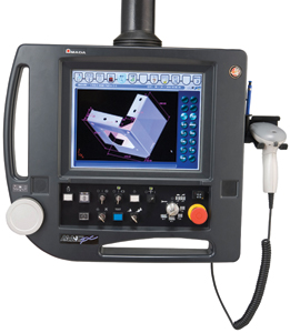

The 3D simulation generated by a virtual bending program displays on the machine’s control, providing a bend-by-bend graphical representation of part placement along the machine. This reduces cycle time and minimizes the risk of misformed parts due to incorrect part placement or sequence errors.

Virtual bending externalizes the intellectual process of creating a bending solution for a part. The program generated includes useful information that can streamline setup and production. Then, when an operator opens the program on the control, he immediately sees a tooling setup sheet, displaying complete information regarding tool type and layout. Quite often, this information is represented graphically. Further, some controls offer interactive touchscreens, which also will interact with a press brake’s backgauge or LED lights that indicate for the operator exact tool placement. This reduces setup time at the machine.
With tool setup complete, the operator now turns his focus to bending. The 3D simulation generated by a virtual bending program displays on the machine’s control, providing a bend-by-bend graphical representation of part placement along the machine. This reduces cycle time and minimizes the risk of misformed parts due to incorrect part placement or sequence errors. With the bend program downloaded to the control, all of the time previously spent entering data into the control is eliminated.
